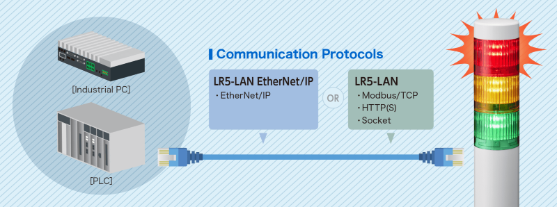

Patlite’s LR5-I (EtherNet/IP) models feature easy wiring using an RJ-45 connector with LAN cable to link PLCs and industrial PCs via a range of communication protocols
Patlite’s LR5-I (EtherNet/IP) models feature easy wiring using an RJ-45 connector with LAN cable to link PLCs and industrial PCs via a range of communication protocols. Image used courtesy of Patlite
Direct LAN Control Replaces Traditional I/O Wiring
Previously, many industrial PC-based systems needed digital output boards to control signal towers and buzzers, which added more parts and made spare part management harder. Patlite’s LR5-LAN series lets users control lights and sounds directly over the network using HTTP(S), Modbus/TCP, or EtherNet/IP.
The LR5-LAN works with several communication protocols to fit different needs. The EtherNet/IP models are made for PLC integration, while the standard LR5-LAN units support Socket communication, Modbus/TCP, and HTTP(S). This flexibility means the new signal towers can be used with PLCs, industrial PCs, and higher-level systems like SCADA and production management platforms.

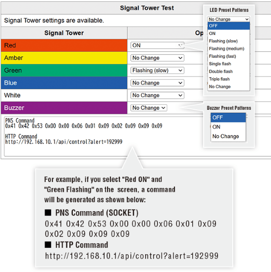

Patlite’s web-browser-based setup screen for the LR5-LAN series
Patlite’s web-browser-based setup screen for the LR5-LAN series. Image used courtesy of Patlite
To make software development easier, the LR5-LAN offers a browser-based command generation feature. After logging into the signal tower, users can choose the desired operation from a setup screen, which automatically creates control commands. This allows users to verify behavior without needing to check manuals. Sample source code is available in several programming languages for both Linux and Windows, making integration and testing faster. The solution also includes seven preset LED flashing patterns, so flashing can be controlled with simple commands instead of PLC timing logic.

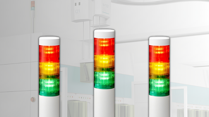

The new LR5-LAN uses the same stackable modular design as other LR series signal towers. Users can easily change the order of the LED colors without tools, allowing flexible customization for different needs. Patlite’s addition of EtherNet/IP-compatible models to the LR5-LAN series extends network-based signaling to more factory systems, reduces wiring complexity, and improves visibility of machine and system status, all of which are important features for the constantly evolving modern smart factories.
