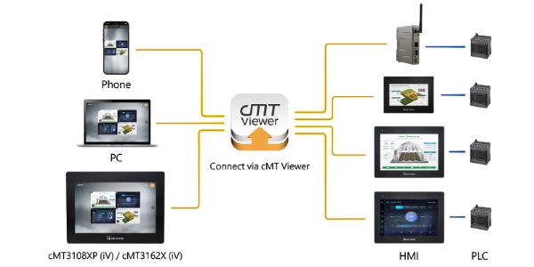

Monitor or Manage Multiple HMIs From A Single Panel
Weintek’s cMT3108XP (iV) and cMT3162X (iV) will also feature a built-in application called cMT Viewer. This application allows operators to monitor and control multiple HMIs at the same time, making it incredibly easy for users to monitor and manage their systems at the same time through the use of multi-user monitoring.
Weintek’s cMT Viewer allows multiple users the ability to view up to six HMIs simultaneously.
Weintek’s cMT Viewer allows multiple users the ability to view up to six HMIs simultaneously. Image used courtesy of Weintek
The cMT Viewer can monitor from up to six HMIs simultaneously and can provide real-time updates on equipment status. Weintek has also prioritized security by using TLS encryption to protect communication data during transmission. It also includes a safety feature that allows for locking specific buttons to prevent unauthorized access, thereby enhancing overall safety during operations.
