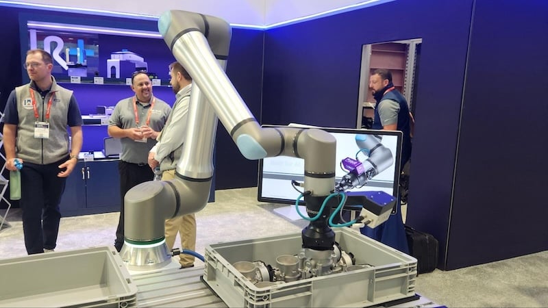

 Figure 1. The new Gen 7 UR robot integrated into an adaptive bin-picking application by InBolt at IMTS.
The new Gen 7 UR robot integrated into an adaptive bin-picking application by InBolt at IMTS. Image used courtesy of Mette McCall, McCall Media

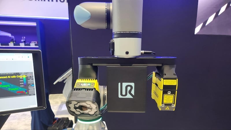

In the new Gen 7 design, we put a lot of effort into the tool flange design. First, a set of soft keys enables a wide range of motion and programming functions without ever picking up the teach pendant. A soft cover over the keys protects them from paint, weld slag, and other ingress.
 Figure 2. The Gen 7 launch includes many updates to the tool flange, the interaction between robot and real world.
The Gen 7 launch includes many updates to the tool flange, the interaction between robot and real world. Image used courtesy of Mette McCall, McCall Media
Electrically, the flange provides more power to tool applications, with up to 3 amps of continuous power for 24- or 48-volt tooling devices. This provides roughly 3x the power available directly via the robot's internal cabling (vs. the previous version), reducing situations that would otherwise require external cables.
It also adds a 1 Gb Ethernet port and an M8 connector for analog, digital, and RS-485 I/O options.
