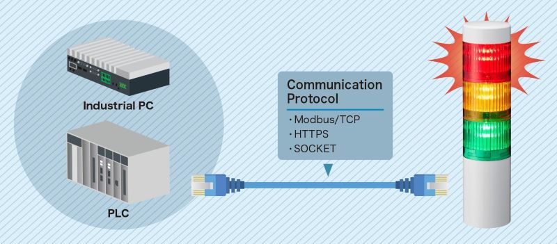

The new LR5-LAN signal tower series can be controlled from either a PLC or industrial PC over several common protocols
The new LR5-LAN signal tower series can be controlled from either a PLC or industrial PC over several common protocols. Image used courtesy of Patlite

Without the need for an output contact board, the LR5-LAN signal tower can be quickly installed and configured. The output from a PLC or industrial PC can be connected to the LR5-LAN with an Ethernet cable, which allows communication via Modbus/TCP, HTTPS, or SOCKET protocols.

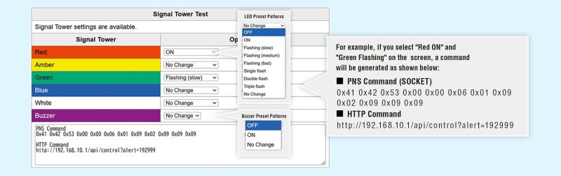

An intuitive software interface enables users to define the criteria for signaling: which color light will illuminate and whether it will flash in a pattern. Patterns include single, double, and triple flashes, as well as slow, medium, and fast continuous flashing speeds. Some models also have an audible alarm (85 dB) that can be programmed for critical errors. Sample code is available from the Patlite website as well.
The LR5-LAN can be configured via intuitive software so users can set which color light illuminates and in what pattern
The LR5-LAN can be configured via intuitive software so users can set which color light illuminates and in what pattern. Image used courtesy of Patlite

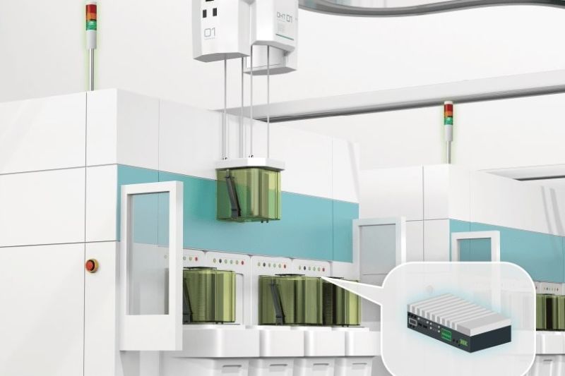

Signal lights are commonly used in large manufacturing environments, such as in semiconductor facilities. When multiple pieces of processing equipment are in use simultaneously, a maintenance technician can simply look down the bay or chase and check the status of all of the signal lights. If they are all green, the technician can move on to the next bay or chase. At a glance, they know exactly which tools need attention and can reduce the time it takes to respond to errors, as well as reduce the number of steps they have to take in a shift.
Semiconductor manufacturing facilities make use of signal lights to speed up troubleshooting and maintenance
Semiconductor manufacturing facilities make use of signal lights to speed up troubleshooting and maintenance. Image used courtesy of Patlite
