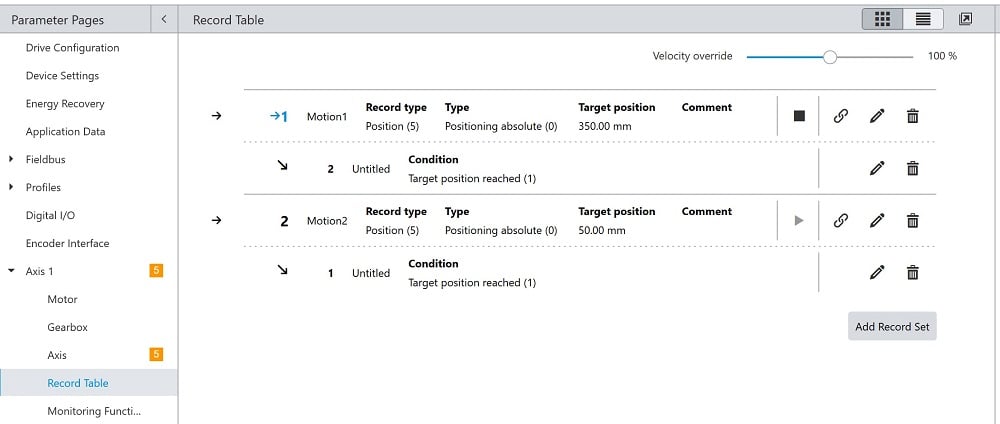

Navigate to the parameterization tab, expand Axis 1 on the left, and click “Record Table.” Add a record set with a target position near the far end of your axis, which is 350 mm for me. Add a second record with a target close to the motor end, perhaps around 50 mm. You might also want to decrease the default velocity when getting started with motion, or you might be in for a surprise.

For each record, press the chain link button, which will open up the transition menu. Again, there are many ways to trigger the transition, but let’s discuss some of the most common:
  • Target Position Reached: The encoder tracks the actual position. This is good for moves without any changing resistance, like a robot on a 7th axis (constant load mass is fine).
  • Target Torque Reached: The motor current is used to monitor a clamping force, and it will stop (without faulting, thank goodness) when a torque is reached–useful for moves with variable-sized loads or positions.
  • Time: a simple timer, but useful for processes that must have a specified duration. DO NOT use a timer to compensate for inaccurate process variables like friction or upstream delays.
  • Digital Input: This provides flexibility for any digital or legacy system, like a robot or a sensor. Don’t have any advanced COM protocol? No problem, use a digital signal.
For our project, we will link according to the target position so that we are isolated from any external factors. When the record target position is reached, link to the second record. Likewise, when the second record position is reached, link to the first record. This will create an infinite cycle.
 Figure 3. Adding transitions to step between the motion record sets.
Restart the device and save the changes. In the "Control" tab, enable the Plug-in and Powerstage. Finally, access the Record Table and play the first record using the triangle play button. Watch it carefully, and be ready to press the stop button if it’s about to collide, but if all is well, your axis should be moving back and forth!

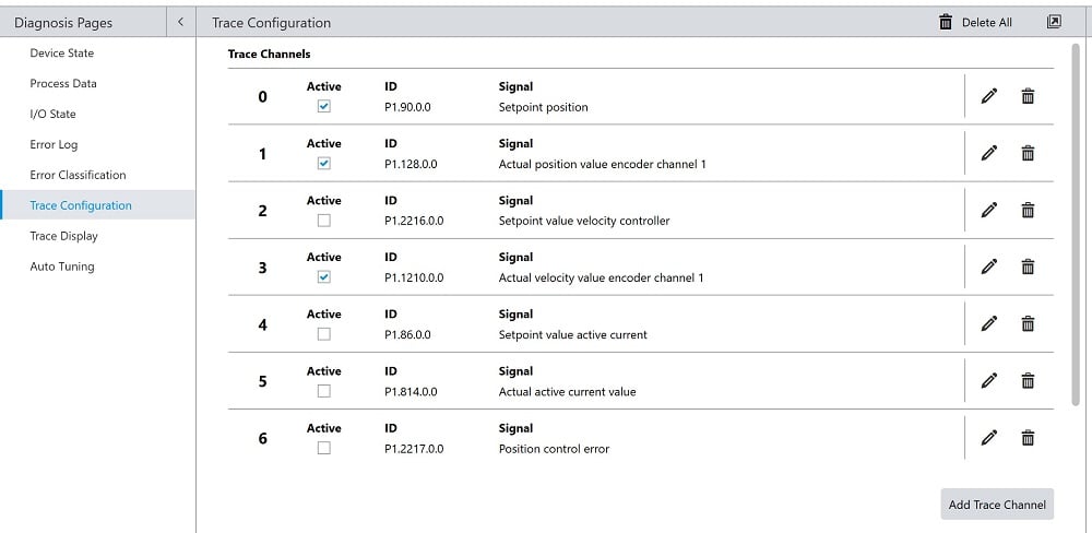

Navigate to the Diagnostics tab and enter Trace Configuration. There are many plot channels already active (like a multi-channel oscilloscope), but they can show nearly any data you could wish! Velocity, current, commanded position, actual position, acceleration, and even config parameters.
Trace Channels
Let’s uncheck all channels except setpoint position, actual position, and actual velocity. The others are fine, but more channels make the plot harder to read.
 Figure 4. We are choosing to view only the setpoint, current position, and current velocity.

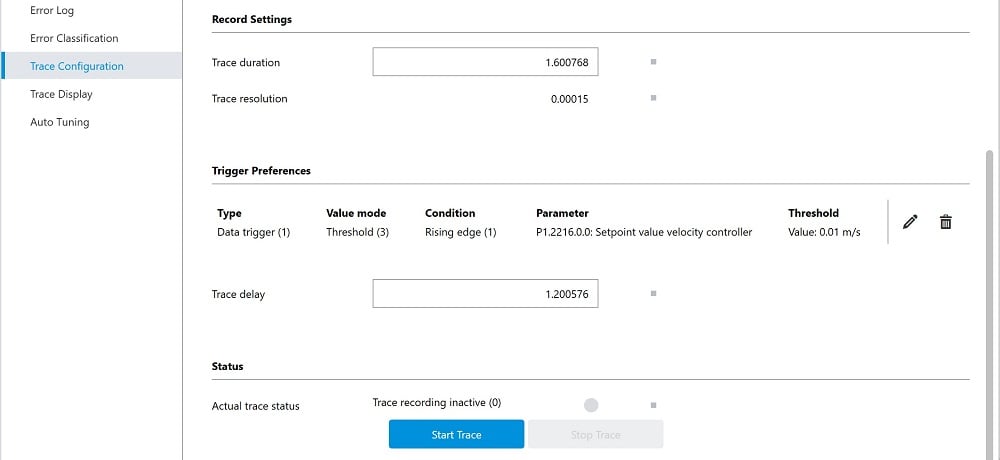

Next, we determine the total length of the recording snapshot. Note: this is not an ongoing live read-out; this will create a fixed image that lasts for the duration specified in the "Trace Duration" box. I will leave the default of ~1.6 seconds.
Trigger Settings
Finally, the Trigger configuration consists of determining what factor is supposed to tell the computer to save and display the snapshot. For this demo, I will choose to get a recording when the velocity rises above 10 mm/sec (you could choose any low value that we are sure to cross).
I will use the common data trigger of “P1.2216.0.0 Setpoint value velocity controller” with a rising edge threshold of 0.01 m/s.
The trace delay is the number of seconds before the event that will be captured and displayed. The total trace duration then is the addition of the trace delay plus the duration after the trigger. I’ll choose 1.2 seconds of trace delay, which means I will also have 0.4 seconds of trace after the trigger event.
 Figure 5. Adding the trigger parameter and starting the trace.
Start and View The Trace
Press the Start Trace button at the bottom to begin monitoring for the trigger event. Once the motion carriage reaches the motor end, then turns around and reverses direction to positive, you will be alerted that a new trace is recorded and is seen in the Trace Display tab on the left.
