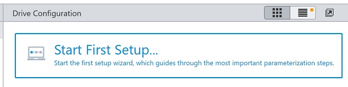

 Figure 5. Starting the first setup wizard.
Start a new ‘First Setup,’ and for each segment of the project, adjust the following parameters:
  1. The drive unit is powered by 24 volts or 48 volts; for this simple setup, the same power supply is used for drive and motor power. If 48 volts is selected for the motor, it will result in a motor braking power fault. Also, enable control via the plug-in so that we can control it right from the PC screen.
  2. Select the proper motor. With the developer kit, this is already a Festo motor, and the part number can be entered directly.
  3. The drive motion needs to know the distance traversed by one full revolution of the motor and the total stroke of the axis.
    A recommended method for calculating the distance of one revolution is to make a small pen or scribe mark at the edge of the motion carriage, then revolve the shaft once by hand and make a new scribe mark. Measure the distance between marks with a caliper. The total stroke is simpler and can be measured with a tape measure if it’s not known.
  4. Any gear or belt speed ratios must be provided. The travel speed will be affected by any ratio changes.
Once any changes have been made, press the “Restart Device” button and save all changes to the device.
