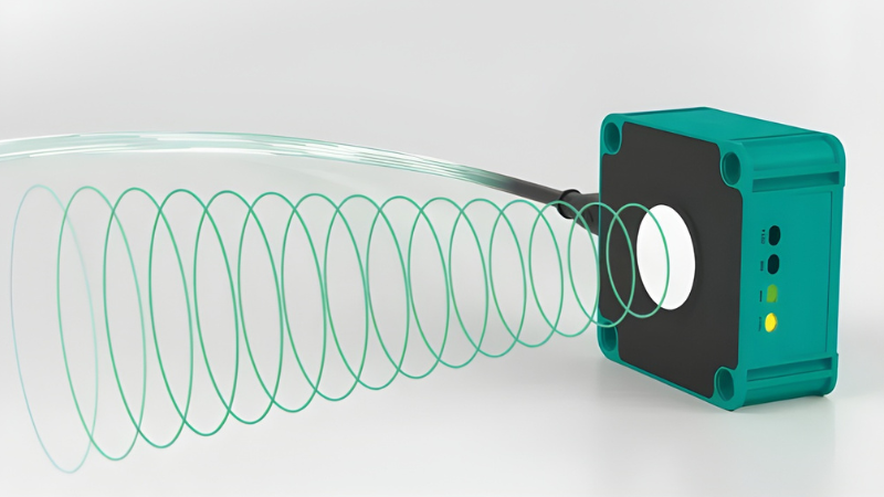

Pepperl+Fuchs has labeled its UB*-F42 ultrasonic sensors as cubical all-rounders
Pepperl+Fuchs has labeled its UB*-F42 ultrasonic sensors as “cubical all-rounders." Image used courtesy of Pepperl+Fuchs

Pepperl+Fuchs has designed the UB*-F42 series for use in challenging environments. The series has a small form factor and includes variants that can be rotated to beam from the larger square sides or the smaller rectangular sides, depending on the application. Furthermore, the package is rated to IP67, meaning it can be used in dirty, dusty environments and in places where water spray may be an issue.

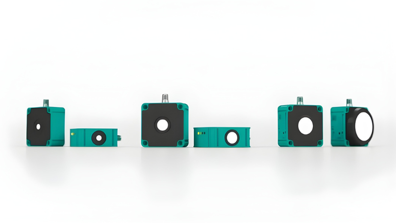

Different models have different beam widths, allowing the detection system to be tailored to a specific application. Wider beams allow detection over larger areas, while smaller beams enable more precise point measurements.
The UB*-F42 series includes variants with different beam widths and sidelooker options
The UB*-F42 series includes variants with different beam widths and "sidelooker" options. Image used courtesy of Pepperl+Fuchs

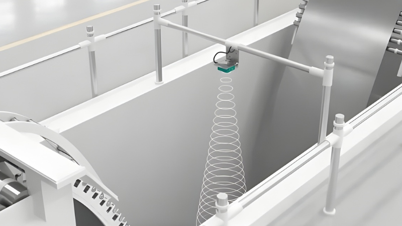

UB*-F42 series ultrasonic sensors can be used to determine the fill level of raw materials, both solids and liquids
UB*-F42 series ultrasonic sensors can be used to determine the fill level of raw materials, both solids and liquids. Image used courtesy of Pepperl+Fuchs

Ultrasonic sensors like the UB*-F42 Series have numerous uses. Pepperl+Fuchs highlighted a few use cases where they expect this sensor to excel. First, fill and stock levels of both solids and liquids are easily measured with this sensor. This makes it a good fit for determining the level in tanks, storage bins, etc., to ensure proper feeding.
