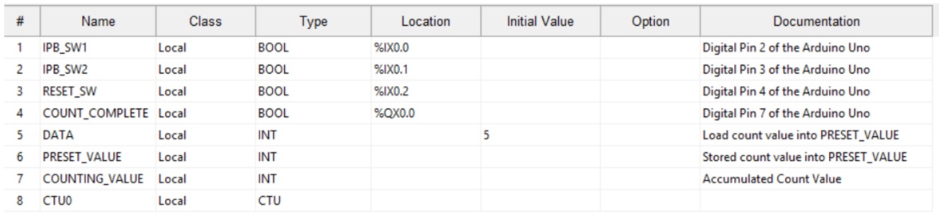

The Tag Listing with documentation is provided in Figure 7. The complete application LD file can be found here.

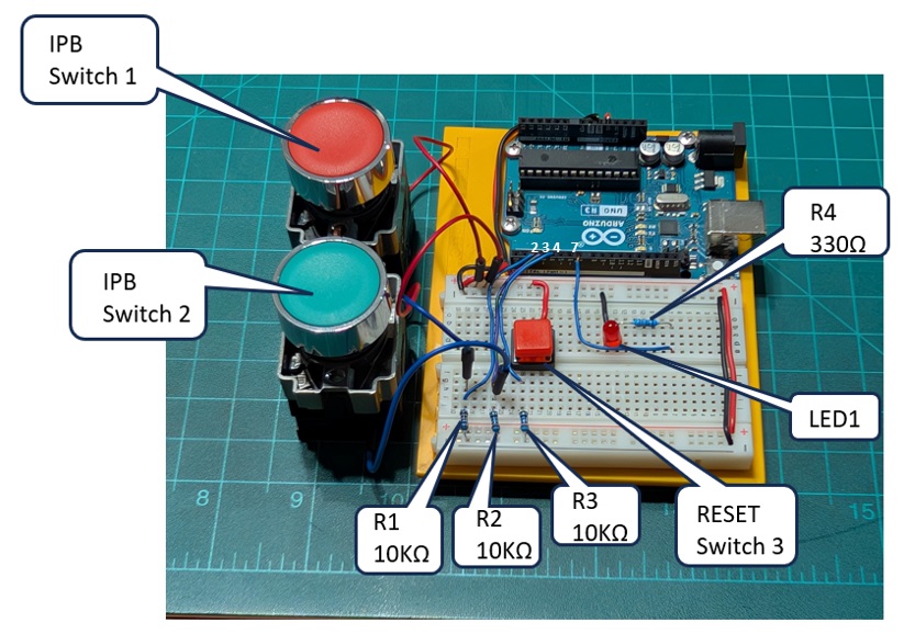

Explaining the flow of logic, pressing the IPB_Switch1 (our red industrial push button) will trigger the MOVE FB and transfer the count value of 5 into the PRESET_VALUE variable.
The counter itself is incremented with a press of IPB_Switch2 (the green industrial push button).
When the COUNTING_VALUE variable equals the PRESET_VALUE variable, the COUNT_COMPLETE coil turns ON. The COUNT_COMPLETE tag is attached to QX0.0, where a red LED is wired to digital pin 7 of the Arduino Uno.
Pressing the RESET_SW switch will reset the counter to 0 and turn OFF the LED.
As a reference, the completed assembly of the Data Manipulator - Counter project is shown in Figure 8.
