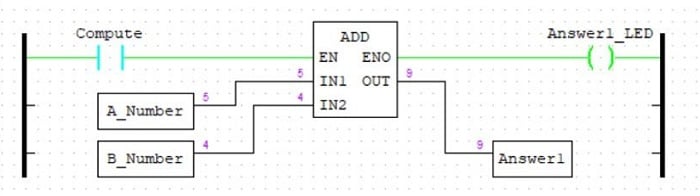

Addition (ADD) FB
The most basic math operation is addition, facilitated by the ADD function block. The ADD command may use multiple input values (usually an analog input or a number stored in memory) and provide exactly one numerical solution. The ADD FB can be used to activate a physical output device like an alarm or pilot alerting the user that a final answer has been computed.
 Figure 2. ADD LD Program.
In this ladder diagram, the Compute button will initiate the arithmetic operation into the EN input. Additional inputs can be included when selecting the ADD command. Lastly, the Enable Out (ENO) digital output will turn on the Answer1_LED indicator.

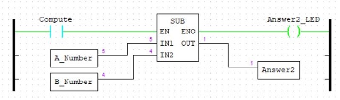

Subtraction (SUB) FB
The math operation of subtraction is essentially the same as a negative addition, but this subtraction is implemented using a SUB function block. Upon closing the Compute button contacts, the two variable data types are subtracted from each other.
In these examples, values have been simulated from the Tag Listing and are shown in purple text. In this example, 5-4=1, a simple example equation. Further, the Enable Out (ENO) pin will turn on the Answer2_LED indicator.
Subtraction calculations can be used to determine error within a PLC pressure monitoring application. The error can be determined by using the SUB FB, given the psi set point and the actual measurement from the designated sensor.
 Figure 3. SUB LD Program.

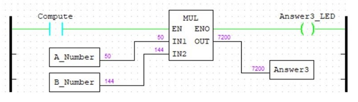

Multiplication (MUL) FB
Multiplication is a series of addition operations, and the MUL FB will perform this operation on two or more variable data types or numbers. The activation operation is the same as the ADD and SUB, an activation of the EN input.
This example will multiply the A_Number by the B_Number (50x144), producing the answer of 7200. This arithmetic instruction may be used for scaling temperature sensor data within a paint process control application, where a calculated temperature value is determined by multiplying the measured analog digital converter (ADC) value by the scale factor.
 Figure 4. MUL LD Program.
