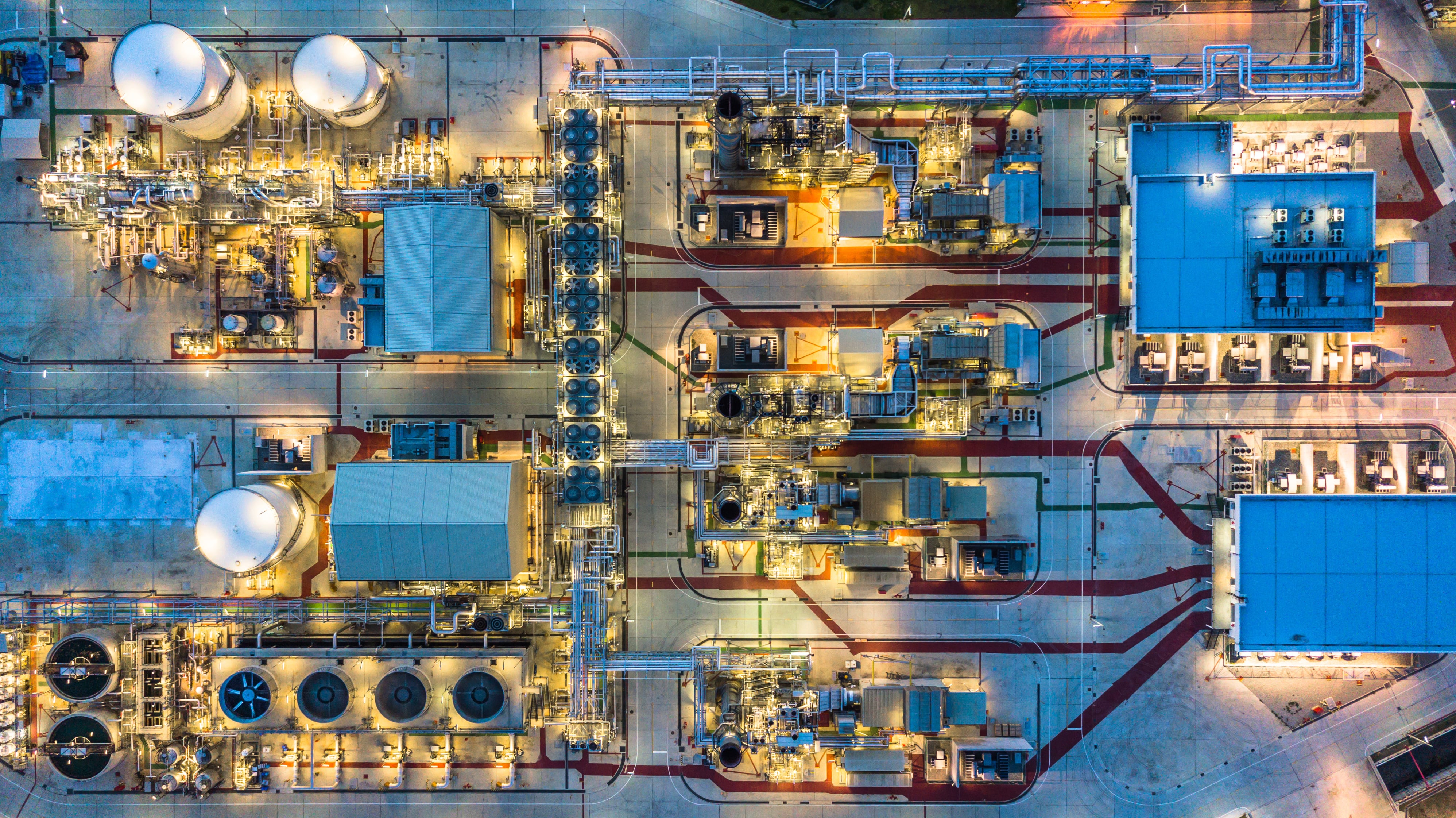

A fault-tolerant system will continue operating despite experiencing errors in one or more parts. Image used courtesy of Adobe Stock
