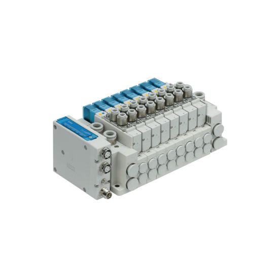

Up to 32 solenoids can be driven with the EX260 series fieldbus system
Up to 32 solenoids can be driven with the EX260 series fieldbus system. Image used courtesy of SMC Corporation
EX260 Series Fieldbus System
The EX260 series fieldbus system is designed for driving multiple port solenoid valves, offering a compact design with a width of approximately 28 mm. It supports up to 32 solenoids and features daisy-chain wiring for communication and power supply, reducing wiring space and complexity. The system is compatible with communication protocols such as EtherNet/IP and PROFINET and includes IO-Link compatibility.
The EX260 series also supports safety communication standards, including PROFIsafe, and offers IP67 protection, making it suitable for various industrial environments. The system's design allows for wiring and piping from the same direction, facilitating easier installation and maintenance. Additionally, the EX260 supports RJ-45 connectors, making it compatible with the widely used Ethernet-based network infrastructure.
