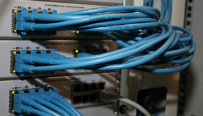

If your data is rather large or the customer requires the data to be stored for an undermined amount of time, you might have to offload the data from the PLC to an edge server. Exporting data from the PLC can be done in a variety of ways.
An OPC UA server is commonly used as most, if not all, PLCs support this protocol. Third-party software can be purchased if your PLC doesn’t support OPC UA natively. Once the data is exposed to the OPC UA server, it can be entered into a relational database.
Cabled network router
Figure 4. Networked systems can store large amounts of data externally to the PLC or offsite form the facility. Image used courtesy of Unsplash
Some companies might opt for a more DIY method and build a TCP listener. TCP messages are sent from the PLC with the data contained in the payload. The listener is a service that resides on the edge computer and receives the messages, decodes the data, and stores the data in a relational database.
Exporting the data from the PLC can happen when the part is offloaded from the equipment or it can occur after each station. Similar to the array and index method mentioned above, each time the pallet enters the station, data is retrieved from the database. When the station work has been completed, the new data is pushed back to the database.
