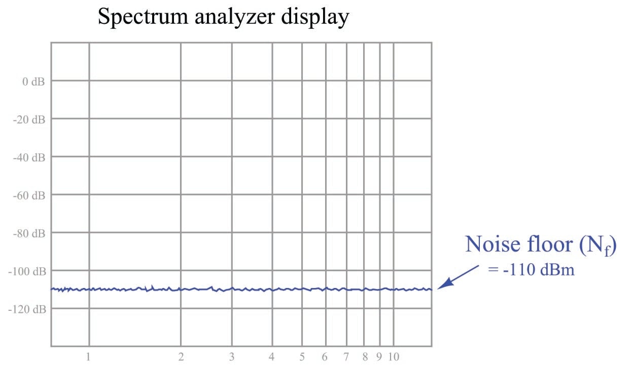

In order for a radio receiver to reliably detect an incoming signal, that signal must be sufficiently greater than the ambient RF noise. All masses at temperatures above absolute zero radiate electromagnetic energy, with some of that energy falling within the RF spectrum. This noise floor value may be calculated or empirically measured using an RF spectrum analyzer as shown in this simulated illustration:
noise floor measured using an RF spectrum analyzer
On top of the ambient noise, we also have the noise figure of the receiver itself (\(N_{rx}\)): noise created by the internal circuitry of the radio receiver. Thus, the minimum signal power necessary for the receiver to operate reliably (\(P_{rx(min)}\)) is equal to the decibel sum of the noise floor and the noise figure, by a margin called the minimum signal-to-noise ratio:
\[P_{rx(min)} = N_f + N_{rx} + S\]

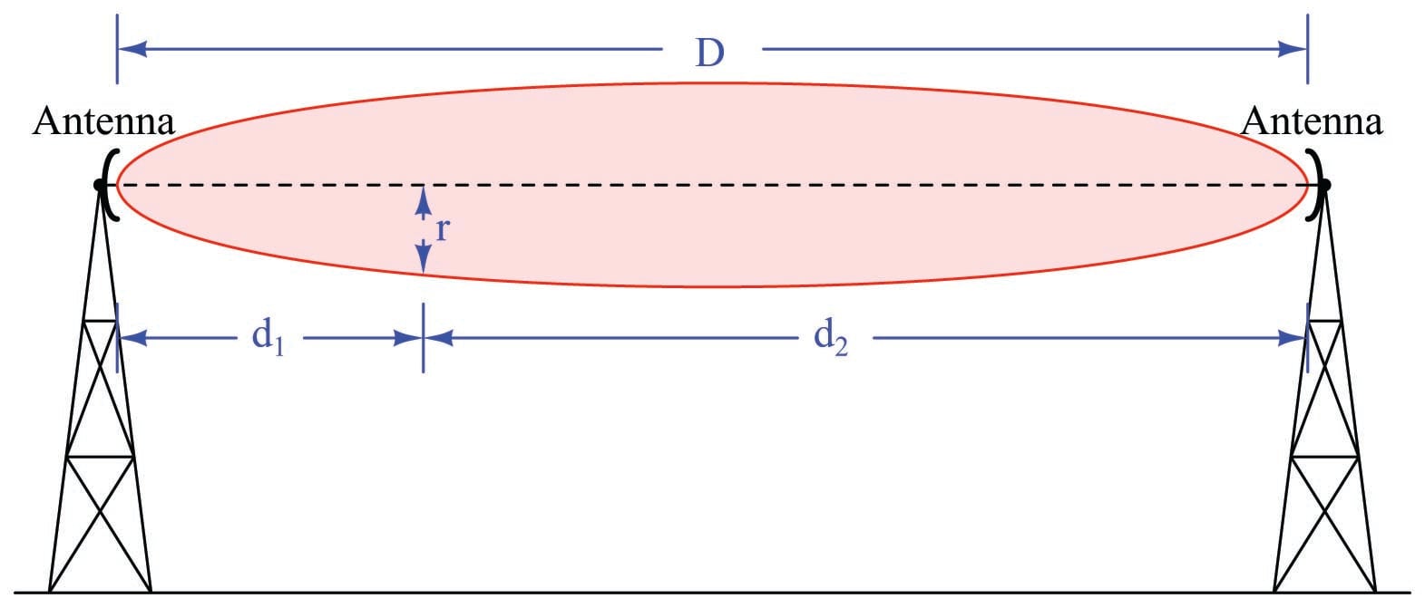

In fact, the free space necessary to convey energy in electromagnetic wave form takes on the form of football-shaped zones: the first one solid followed by annular (hollow) zones concentrically surrounding the first. These elliptical volumes are called Fresnel zones:
Fresnel zones diagram
The precise shapes of these Fresnel zones are a function of wavelength and distance between antennas, not the size or configurations of the antennas themselves. In other words, you cannot change the Fresnel zone sizes or shapes by merely altering antenna types. This is because the Fresnel zones do not actually map the distribution of electromagnetic fields, but rather map the free space we need to keep clear between antennas.
If any object protrudes at all into any Fresnel zone, it diminishes the signal power communicated between the two antennas. In microwave communication (GHz frequency range), the inner-most Fresnel zone carries most of the power, and is therefore the most important from the perspective of interference. Keeping the inner-most Fresnel zone absolutely clear of interference is essential for maintaining ideal path-loss characteristics (equivalent to open-space). A common rule followed by microwave system designers is to try to maintain an inner Fresnel zone that is at least 60% free of obstruction.
In order to design a system with this goal in mind, we need to have some way of calculating the width of that Fresnel zone. Fortunately, this is easily done with the following formula:
\[r = \sqrt{{n \lambda d_1 d_2} \over D}\]
Where,
\(r\) = Radius of Fresnel zone at the point of interest
\(n\) = Fresnel zone number (an integer value, with 1 representing the first zone)
\(d_1\) = Distance between one antenna and the point of interest
\(d_2\) = Distance between the other antenna and the point of interest
\(D\) = Distance between both antennas
\(\lambda\) = Wavelength of transmitted RF field, in same physical unit as \(D\), \(d_1\), and \(d_2\)
Note: the units of measurement in this formula may be any unit of length, so long as they are all the same unit.
To illustrate by example, let us calculate the radius of the first Fresnel zone for two microwave antennas operating at 2.4 GHz, separated by one mile (1.609 km), at the widest portion of that zone. The wavelength of a 2.4 GHz signal is 0.1249 meters, from the formula \(\lambda = {c \over f}\). Distances \(d_1\) and \(d_2\) will both be equal to one-half of the total distance, since the widest portion of the Fresnel zone will be exactly at its mid-point between the two antennas (\(d_1 = d_2\) = 804.7 meters). Here, we solve for \(r\) as follows:
\[r = \sqrt{{(1) (0.1249) (804.7^2)} \over 1609}\]
\[r = 7.089 \hbox{ meters}\]
Consider for a moment the significance of this dimension. At the very least, it means the antennas must be mounted this high off the ground in order to avoid having the most important Fresnel zone contact the earth itself (assuming level terrain), not to mention any objects above ground level such as buildings, vehicles, or trees between the two antennas. Consider also that the Fresnel zone is football-shaped, and therefore this 7.089 meter radius extends horizontally from the centerline connecting both antennas as well as vertically. This means that in order for this Fresnel zone to be untouched, there must be a clear path 14.18 meters wide in addition to the antennas being at least 7.089 meters off the ground! If we were to consider a 900 MHz signal – another common frequency for industrial wireless devices – the minimum height above ground would be 11.58 meters, and the minimum clear path width 23.16 meters!
As you can see, “line of sight” is not as simple as it may first appear.
