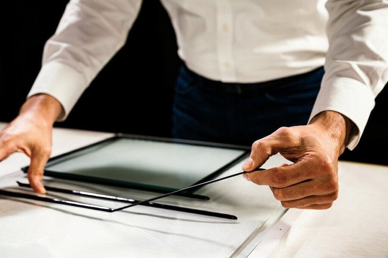

A look at 3M’s UHB Extrudable Tape cooled. Image used courtesy of 3M
The tapes contain all of the chemicals required for the adhesion, but unlike an office tape dispenser, there is more to this system. The tapes are fed into the Nordson ProBond system where the tape is melted and extruded in very small, tightly controlled quantities. The heating and melting changes the chemistry, meaning the adhesion of the melted substance is greater than that of the tape by itself. Once the adhesive cools, it has bonded the parts, no curing time required.
