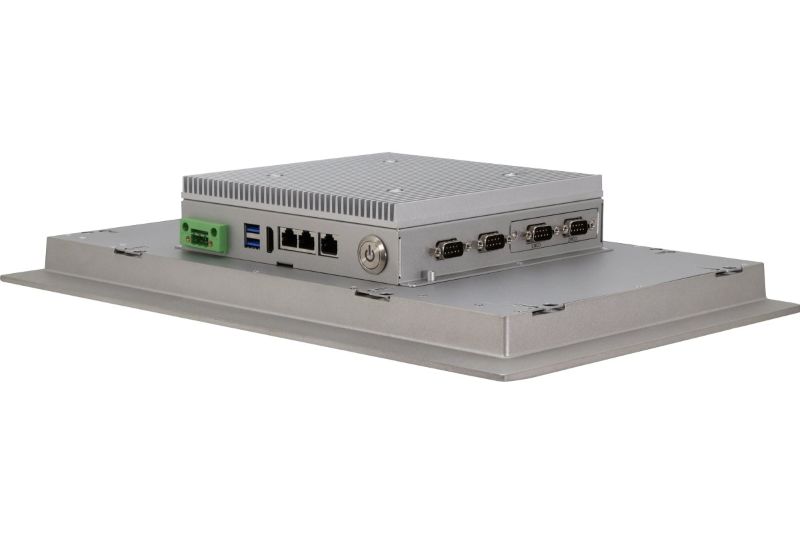

The OMNI-ADN HMI panel PCs feature DB-9, RJ-45, USB, and HDMI ports
The OMNI-ADN HMI panel PCs feature DB-9, RJ-45, USB, and HDMI ports. Image used courtesy of Aaeon

For connectivity, the OMNI-ADN series includes dual DB-9 serial ports (RS-232/422/485), three 2.5 GbE RJ-45 Ethernet ports, two USB 3.2 Gen 2 connections, and an HDMI output. The dual DB-9 ports support communication with PLCs, motor drives, and industrial sensors.
Multiple Ethernet ports allow the HMI to function as a bridge between internal control networks and higher-level IT systems. The HDMI port may be useful in setups that require an auxiliary display for diagnostics or operator viewing at a remote location.
