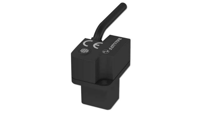

Balluff has launched a compact inductive position sensor for wear-free position monitoring in tight industrial spaces. The BIP002R measures up to 7 mm and supports both analog and IO-Link interfaces, making automation and manufacturing tasks more efficient.
The BIP002R provides high-precision inductive sensing in a compact form factor
The BIP002R provides high-precision inductive sensing in a compact form factor. Image used courtesy of Balluff

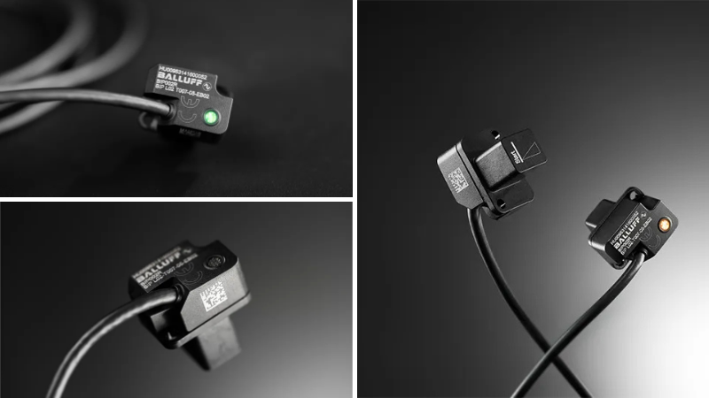

The new BIP002R inductive position sensor combines IO-Link and analog communication in one compact unit. It works with standard industrial control systems and allows for digital setup and diagnostics. Users can choose between 0–10 V and 4–20 mA analog outputs, making it suitable for both legacy equipment and modern Industry 4.0 systems.
Balluff offers both vertical and horizontal cable exit options for the BIP002R sensor, making it easier to integrate into tight automation setups and helping reduce cable stress in moving applications. With its compact size of 22 mm × 23.7 mm × 15 mm, the sensor is well-suited for precise tasks like monitoring fixture positions, automated clamping, CNC tool changes, and robotic tooling. These uses often require accurate positioning feedback without the bulk and wear of contact-based sensors.
The BIP002R combines analog and IO-Link connectivity for installation in new and existing equipment
The BIP002R combines analog and IO-Link connectivity for installation in new and existing equipment. Image used courtesy of Balluff
