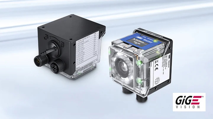

Baumer, a leading global provider of sensors, encoders, and components for automated image processing, has launched an all-in-one vision system that complies with GigE Vision and GenICam standards. The new IX series is designed to demonstrate the straightforward setup and usage of GigE Vision cameras for factory automation.
Baumer's new IX series is made up of ultra-compact and GigEVision-compliant cameras.
Baumer's new IX series is made up of ultra-compact and GigE Vision-compliant cameras. Image used courtesy of Baumer
Baumer’s IX Vision System
The IX series PC-based GigE camera brings together all image acquisition components into a single, streamlined housing. This innovative design aims to minimize end-user frustration by eliminating the need for external component connectivity, protective enclosures for sensitive hardware, and complex wiring management for machine builders. This all-in-one camera is also equipped with integrated segmentable lighting and an autofocus feature, allowing for rapid integration and setup.
Baumer currently offers three models of the new high-performance monochrome cameras: the VIXG-10M.W.06, the VIXG-10M.W.08, and the VIXG-10M.W.16. These cameras boast a crystal-clear resolution of 1280 x 800 px with an operating distance of 50 to 1000 mm (100 to 1000 mm for the VIXG-10M.W.16). Camera features also include lightning-fast Gigabit Ethernet connectivity, a frame rate of 50 frames per second, status LED indicators for easy troubleshooting, a sturdy housing with an industrial rating of IP 67 for use in harsh industrial environments that could expose the camera to liquids and dust, and the option to add a clip-on polarization filter for enhanced image quality. The key point of distinction among these models lies in their integrated lens sizes, which are 6 mm, 8 mm, and 16 mm, respectively.
Baumer's IX series is made up of all-in-one, ready-to-use industrialcameras for factory automation.
Baumer's IX series is made up of all-in-one, ready-to-use industrial cameras for factory automation. Image used courtesy of Adobe Stock
