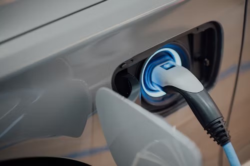

Electric vehicle charger
An energy meter can monitor, log, and even optimize EV charging. Image used courtesy of Unsplash
