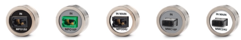

CertiFiber Max uses field-replaceable UniPort adapters to connect directly to multi-fiber interfaces. The adapters support MPO connectors with 12, 16, or 24 fibers, as well as 16- and 24-fiber MMC connectors, in both pinned and unpinned versions. This also eliminates the need for fan-out cables or connector-specific test setups, allowing the tester to be reconfigured in the field as connector types change.
UniPort adapters provide direct MPO and MMC connectivity and can be swapped in the field as connector types change.
UniPort adapters provide direct MPO and MMC connectivity and can be swapped in the field as connector types change. Image used courtesy of Fluke
Because UniPort adapters are field-replaceable, the tester can be adapted as connector types evolve. The adapters also protect the tester’s ports from wear, helping extend tool life in high-volume testing environments.
