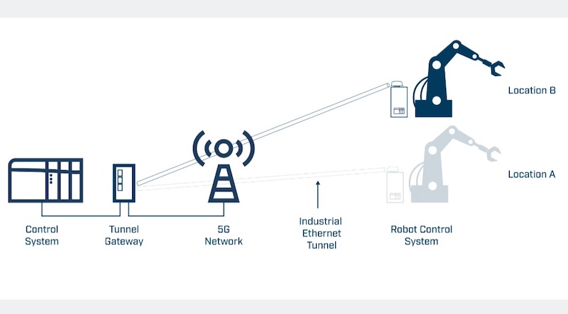

The wireless Anybus system is paired with the Anybus Tunnel Gateway to provide 5G-enabled communication across several key industrial networks (PROFINET, EtherNet/IP, or Modbus TCP, in addition to all TCP and UDP-based communication). The industrial ethernet tunnel serves as a bridge, enabling LLDP and device discovery, connecting low-level communication (layer 2) with the 5G network (layer 3) to the Anybus Wireless Bolt 5G. This makes the Bolt 5G applicable to real-time and deterministic protocols.
The top section of the device uses a rubber gasket seal, achieving an ingress protection rating of IP67. This rating means that the device is impervious to the ingress of dust and other solid particulates and can be submerged (temporarily) in water at a depth of a meter for 30 minutes. The internal safety rating for the device is IP30, protecting tools and wires more than 2.5 mm.
With the Anybus Wireless Bolt 5G and the Anybus Tunnel Gateway, no programming is needed when moving industrial machinery. The PLC or industrial controller will still register machinery as connected through an ethernet cable.
With the Anybus Wireless Bolt 5G and the Anybus Tunnel Gateway, no programming is needed when moving industrial machinery. The PLC or industrial controller will still register machinery as connected through an ethernet cable. Image used courtesy of HMS Networks
