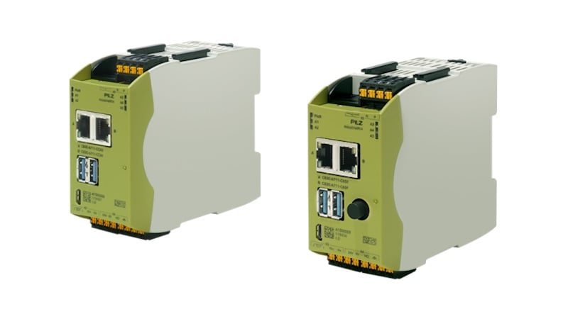

Pilz has released the IndustrialPI, a versatile and modular industrial PC designed to meet the diverse needs of modern automation and drive technology. Leveraging open-source software and a variety of input and output modules, the IndustrialPI can function as an IIoT (Industrial Internet of Things) gateway or a soft PLC. This innovative solution simplifies the implementation of Industry 4.0 concepts, offering users a familiar and adaptable platform for various industrial applications.
The Pilz IndustrialPI functions as an industrial gateway for modern automation.
The Pilz IndustrialPI functions as an industrial gateway for modern automation. Image used courtesy of Pilz

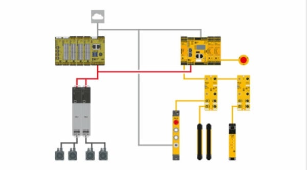

An IndustrialPI schematic in an IIoT application.
An IndustrialPI schematic in an IIoT application. Image used courtesy of Pilz

Having observed how performance depends on underlying operating systems and hardware, let's examine the specifications behind IndustrialPI. The IndustrialPI is offered in the IndustrialPI 4 and the IndustrialPI 4 Wi-Fi versions. The IndustrialPI 4 has hardware that makes it more suitable for automation applications as a soft PLC. The Pi 4 has 4 GB of RAM, 32 GB eMMC data memory, and a 64-bit operating system.
The IndustrialPI 4 Wi-Fi is an industrial PC with 8 GB of RAM, 32 GB eMMC storage, and a 64-bit operating system. It can function as a gateway, data collector, and diagnostic unit. When used with the PNOZmulti 2 safety controller and the PSS 4000 automation system from Pilz, it creates a robust solution for data exchange between the Internet of Things and cloud services.
This setup allows for flexible and customized applications to help users manage costs effectively. The IndustrialPI 4 Wi-Fi supports various industrial protocols and can be integrated into different networks, making it adaptable to various industrial automation tasks.
An Industrial Raspberry Pi?
The IndustrialPI is an industrial-grade version of the Raspberry Pi, which many people use for personal projects. The IndustrialPI retains the open-source nature of the Raspberry Pi, meaning it supports a wide range of software and development tools. It comes pre-installed with an operating system tailored for industrial use, which includes Node-RED. Node-RED is a user-friendly, open-source tool that allows easy programming and rapid prototyping of automation tasks through a visual reference. All of these functions, specifications, and familiarity make the IndsutrialPi flexible and customizable, helping users manage costs and adapt the device to their specific needs.
