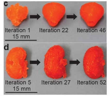

The progress of better models on prostate (top) and kidney (bottom) models
The progress of better models on prostate (top) and kidney (bottom) models. Image (modified) used courtesy of Advanced Materials Technology

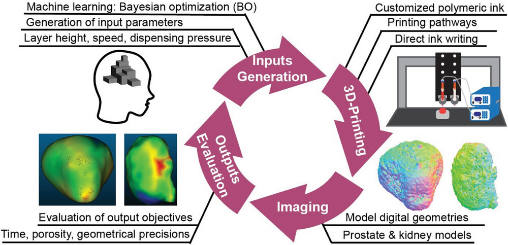

In the Washington State University research, AI-driven model improvements were made to a direct ink writing (DIW) 3D printer using a Bayesian Optimization method. In this optimization, important process parameters, such as nozzle velocity, dispensing pressure, layer height, etc., are automatically varied. Using machine vision and imaging, AI then measures or calculates critical metrics about the organ, such as porosity and geometric precision. The input process parameters are altered based on the data from these metrics. Through testing, more than 60 iterations were performed to print an optimized presurgical kidney and prostate model.
Washington State University researchers’ optimization and design process. Image used courtesy of Advanced Materials Technology
The drive for this project was not to directly produce kidney and prostate models, however. It was to prove the validity of using their Bayesian Optimization algorithm in a machine learning and AI-type environment. Once this methodology is verified, its application cases could be expanded to include other organ models and intricate parts used in manufacturing, like sensors and batteries.
Ultimately, the algorithm’s handling of the prostate model was better than that of the kidney model, but it does show that the methodology is sound. The algorithm can be adjusted slightly to improve the usability of the kidney model, perhaps by using additional inputs or figuring out why the changes between the later iterations did not alter the final design significantly.
