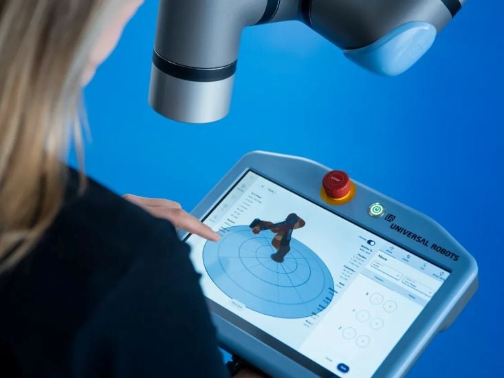

The cobot features UR’s new OptiMove motion control system. OptiMove is engineered to deliver smoother trajectories and consistent accuracy even at high speeds. This is critical in environments where even small inconsistencies can lead to defects or downtime. As a result, the UR15 offers manufacturers a powerful tool without the need for bulky hardware or complex integration by combining a small form factor with robust motion performance.
The UR15 features UR’s OptiMove motion control technology, enabling precise movements despite higher speeds
The UR15 features UR’s OptiMove motion control technology, enabling precise movements despite higher speeds. Image used courtesy of Universal Robots
