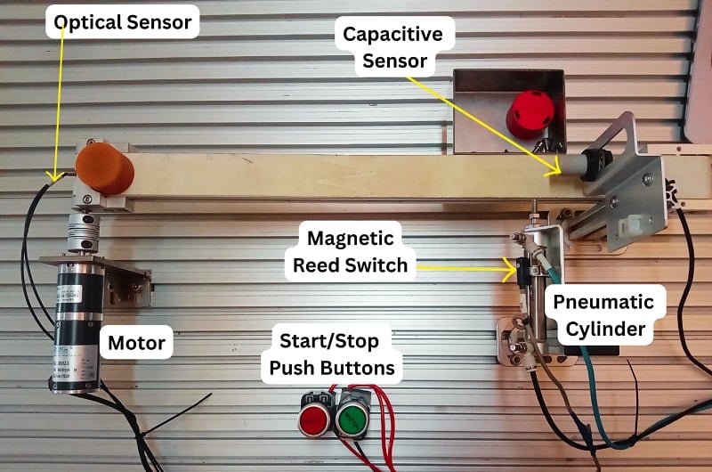

For this tutorial, let's consider a simple automation project that features a conveyor system, sensors, and a pneumatic cylinder that acts as a pusher. In this project, we are going to compare the sequential control aspect using traditional logic and the use of Step and Return functions.
 Figure 1. Sample project to demonstrate the use of Step and Return functions.
Before looking at how to implement the sequential logic for the sample project, consider understanding the sequence of operations. In the case of the project example in Figure 1, the operation sequence is as follows:
  1. The start push button (green) is pressed to start the process.
  2. The conveyor starts running once an item is detected by the optical sensor.
  3. The conveyor stops once the capacitive sensor detects the item at the conveyor's endpoint.
  4. A pneumatic piston pushes the item to a collection bin and retracts.
  5. The system returns to step 2, ready for the next item.

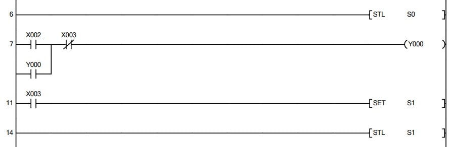

Step 2 (S1)
When the optical sensor (X002) detects an item, the conveyor motor (Y000) activates and is stopped by the item detection with the capacitive sensor (X003). This capacitive sensor is used to trigger the next step, S1.
 Figure 4. Continuation of the sequential logic illustrating the conveyor motion until the item is detected by the capacitive sensor (X003), setting the next step, S1.
Figure 4. Continuation of the sequential logic illustrating the conveyor motion until the item is detected by the capacitive sensor (X003), setting the next step, S1. Image used courtesy of the author

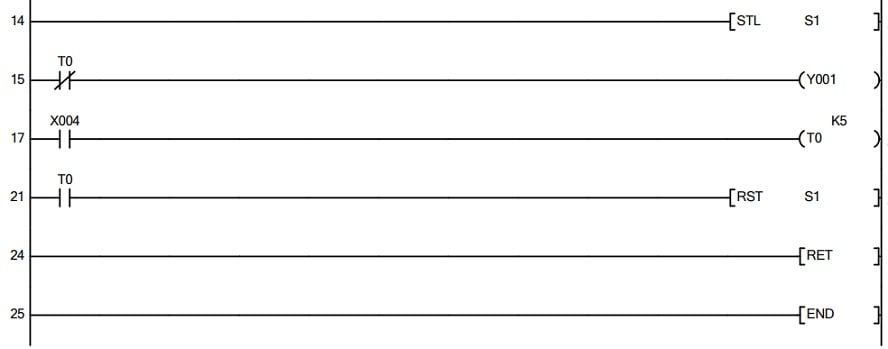

Note that from Figure 4 above, when the next step in the sequence is activated, the previous step, in this case, S0, is automatically deactivated. This can cause challenges if the sequence is the last in the logic and might prompt the need for adding a timer (or event) to cancel and reset the last step, S1, as seen in Figure 5. In some cases, if you intend to loop a repetitive task, a normally closed contact of the last step can be added in series with the condition that activates the first step. In this project, however, when the pneumatic cylinder extends to push the object, the magnetic reed switch (X004) is triggered, which starts a time count to reset this final step. RET is added immediately after the logic within this last step.
Final step in STL / RET PLC Logic
Figure 5. The final sequential logic handles the extension and retraction of the pneumatic pusher and features RET instruction.
