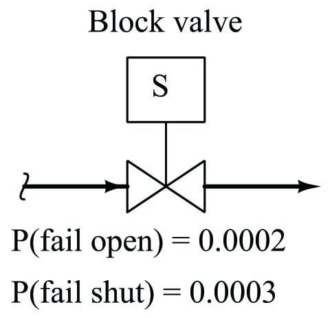

A practical application of this would be the calculation of failure probability for a double-block valve assembly, designed to positively stop the flow of a dangerous process fluid. Double-block valves are used to provide increased assurance of shut-off, since the shutting of either block valve is sufficient in itself to stop fluid flow. The probability of failure for a double-block valve assembly – “failure” defined as not being able to stop fluid flow when needed – is the product of each valve’s un-dependability (i.e. probability of failing in the open position when commanded to shut off):
With these two valves in service, the probability of neither valve successfully shutting off flow (i.e. both valve 1 and valve 2 failing on demand; remaining open when they should shut) is the product of their individual failure probabilities.
\[P(\hbox{assembly fail}) = P(\hbox{valve 1 fail open}) \times P(\hbox{valve 2 fail open})\]
\[P(\hbox{assembly fail}) = 0.0002 \times 0.0003\]
\[P(\hbox{assembly fail}) = 0.00000006 = 6 \times 10^{-8}\]

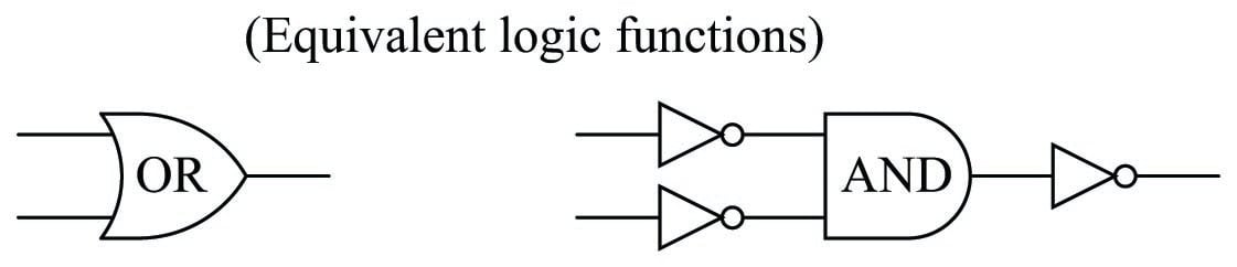

We already know the complement (inversion) of a probability is the value of that probability subtracted from one (\(\overline{P} = 1 - P\)). This gives us a way to symbolically express the DeMorgan’s Theorem definition of an OR function in terms of an AND function with three inversions:
Knowing that \(\overline{P}(A) = 1 - P(A)\) and \(\overline{P}(B) = 1 - P(B)\), we may substitute these inversions into the triple-inverted AND function to arrive at an expression for the OR function in simple terms of \(P(A)\) and \(P(B)\):
\[P(A \hbox{ or } B) = \overline{\overline{P}(A) \times \overline{P}(B)}\]
\[P(A \hbox{ or } B) = \overline{(1 - {P}(A)) (1 - {P}(B))}\]
\[P(A \hbox{ or } B) = 1 - \left[(1 - {P}(A)) (1 - {P}(B))\right]\]

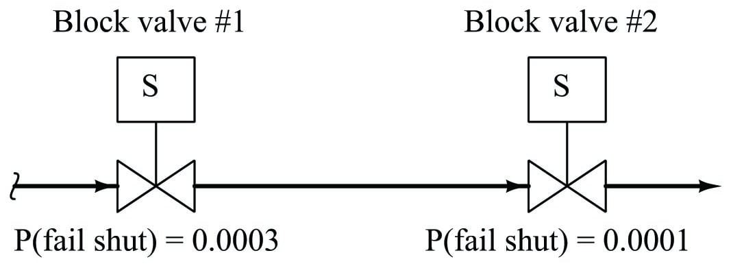

We may return to our example of a double-block valve assembly for a practical application of OR probability. When illustrating the AND probability function, we focused on the probability of both block valves failing to shut off when needed, since both valve 1 and valve 2 would have to fail open in order for the double-block assembly to fail in shutting off flow. Now, we will focus on the probability of either block valve failing to open when needed. While the AND scenario was an exploration of the system’s un-dependability (i.e. the probability it might fail to stop a dangerous condition), this scenario is an exploration of the system’s un-security (i.e. the probability it might fail to resume normal operation).
Each block valve is designed to be able to shut off flow independently, so that the flow of (potentially) dangerous process fluid will be halted if either or both valves shut off. The probability that process fluid flow may be impeded by the failure of either valve to open is thus a simple (non-exclusive) OR function:
\[P(\hbox{assembly fail}) = P(\hbox{valve 1 fail shut}) + P(\hbox{valve 2 fail shut}) - P(\hbox{valve 1 fail shut}) \times P(\hbox{valve 2 fail shut})\]
\[P(\hbox{assembly fail}) = 0.0003 + 0.0001 - (0.0003 \times 0.0001)\]
\[P(\hbox{assembly fail}) = 0.0003997 = 3.9997 \times 10^{-4}\]

A practical example of the exclusive-or (XOR) probability function may be found in the failure analysis of a single block valve. If we consider the probability this valve may fail in either condition (stuck open or stuck shut), and we have data on the probabilities of the valve failing open and failing shut, we may use the XOR function to model the system’s general unreliability. We know that the exclusive-or function is the appropriate one to use here because the two “input” scenarios (failing open versus failing shut) absolutely cannot occur at the same time:
\[P(\hbox{valve fail}) = P(\hbox{valve fail open}) + P(\hbox{valve fail shut})\]
\[P(\hbox{valve fail}) = 0.0002 + 0.0003\]
\[P(\hbox{valve fail}) = 0.0005 = 5 \times 10^{-4}\]
If the intended safety function of this block valve is to shut off the flow of fluid if a dangerous condition is detected, then the probability of this valve’s failure to shut when needed is a measure of its undependability. Conversely, the probability of this valve’s failure to open under normal (safe) operating conditions is a measure of its unsecurity. The XOR of the valve’s undependability and its unsecurity therefore represents its unreliability. The complement of this value will be the valve’s reliability: \(1 - 0.0005 = 0.9995\). This reliability value tells us we can expect the valve to operate as it’s called to 99.95% of the time, and we should expect 5 failures out of every 10,000 calls for action.

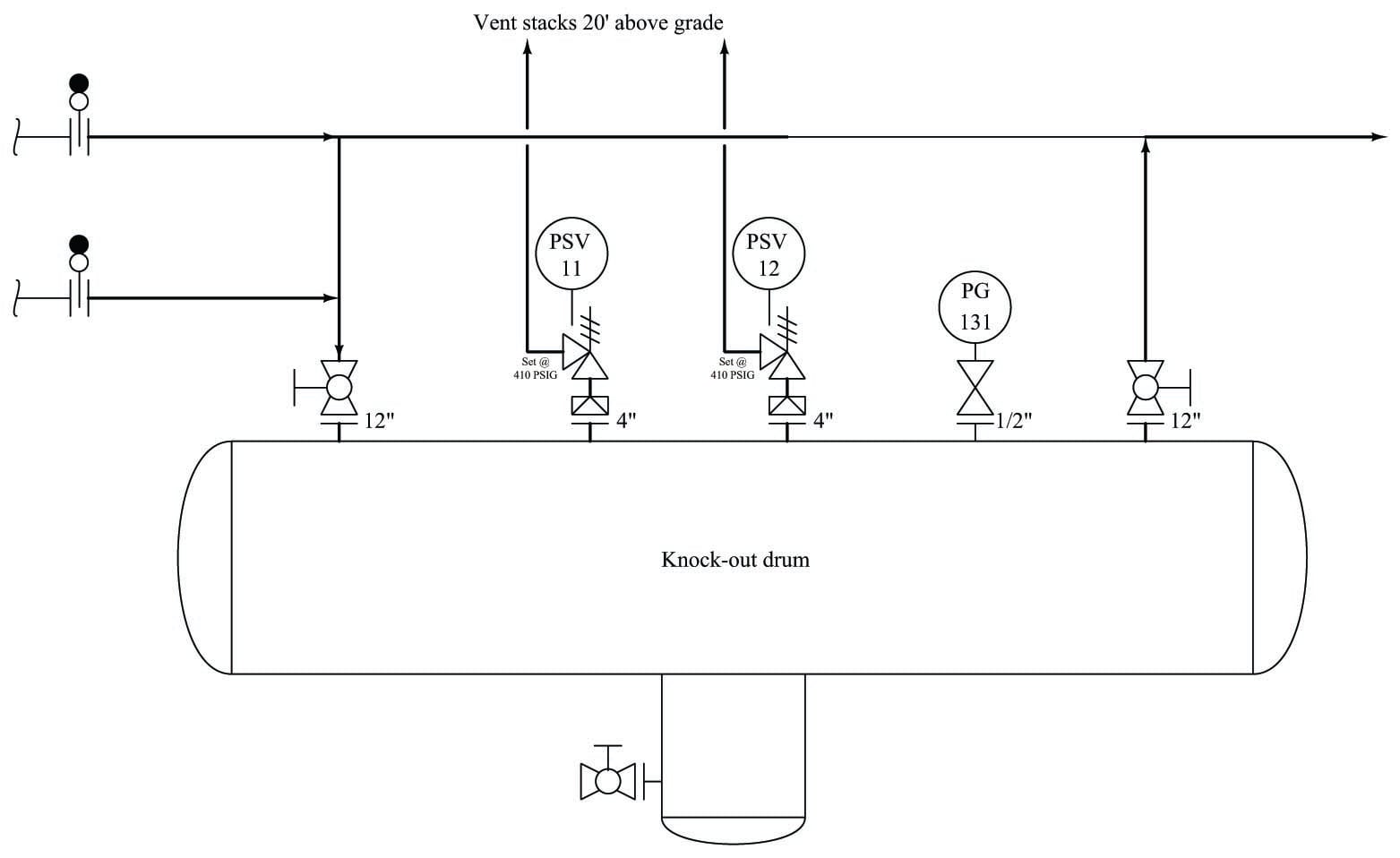

To illustrate, we will examine the overpressure protection features of a “knock-out drum” used to collect small amounts of liquid entrained in a gas stream. This particular vessel is equipped with two pressure-safety valves (PSV-11 and PSV-12) designed to open and vent gas to atmosphere in the event of an overpressure condition (over 410 PSIG):

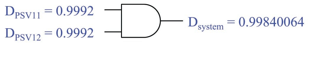

Suppose each of these pressure safety valves has a dependability (\(D\)) rating of 0.9992, which means each one has a 99.92% chance of opening up to relieve excess pressure when a high-pressure condition exists. Let us also suppose each of these PSVs has a security (\(S\)) rating of 0.995, which means each one has a 99.5% chance of remaining in the shut condition when no overpressure condition exists. Furthermore, assume each of the two pressure safety valves individually has a high enough flow capacity to adequately vent the vessel during an overpressure condition.
How might we calculate the overall dependability and security ratings of this dual-PSV overpressure protection system? Clearly, we must use Boolean functions to combine the two valves’ \(D\) ratings into a \(D_{system}\) rating, and likewise with the two valves’ \(S\) ratings, but which logical function should we use to calculate each measure of reliability? The choice between AND and OR functions may not be obvious at first inspection.
One way to analyze logical functions is in terms of what state (0 or 1) at any input will guarantee a certain output state. For an AND function, any 0 state in guarantees a 0 state out. For an OR function, any 1 state in guarantees a 1 state out. These facts are useful when selecting logical functions for a variety of purposes, and they will serve us well in this application of probability values too.
A useful problem-solving technique for this application is called limiting cases, where we take some quantity to its extreme limits in an effort to simply the problem at hand. To begin, we will assume that one of the two pressure safety valves in this system has a \(D\) rating of 1, which means it is perfectly reliable when called to open by a high-pressure condition. A \(D\) rating of 1 is a “limiting case” of the pressure safety valve’s dependability: a perfectly dependable PSV. If this were true, would it guarantee the whole overpressure protection system is dependable, or not? Since we know each valve is sized large enough to protect the vessel on its own (without need of the second PSV opening), then the answer to this question is “yes”: a single PSV with a \(D\) rating of 1 guarantees a \(D_{system}\) rating of 1. All we need is for one of these PSVs to vent when it senses a high-pressure condition to protect the vessel from overpressure damage. Therefore, the proper Boolean function to calculate \(D_{system}\) from the valves’ individual \(D\) ratings is the OR function, because given the choices of AND and OR only the OR function guarantees a certain output state with any “1” input. Calculating system dependability using both valves’ \(D\) ratings:
The numerical results shown here should make sense: in an overpressure protection system where we only need one of the two valves to vent gas during an overpressure condition, having two valves increases the probability that the vessel will be adequately protected.
