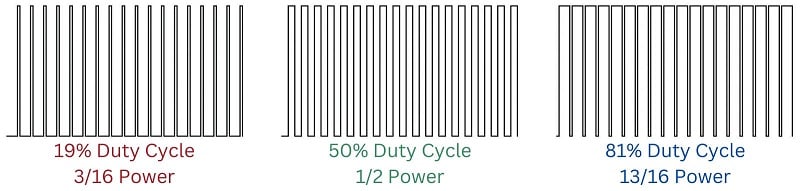

A better solution is to have an electronic power control circuit very rapidly switch transistors on and off, switching power to the motor armature. This is called pulse-width modulation, or PWM.
The duty cycle (on time versus on+off time) of the pulse waveform will determine the fraction of total power delivered to the motor:
