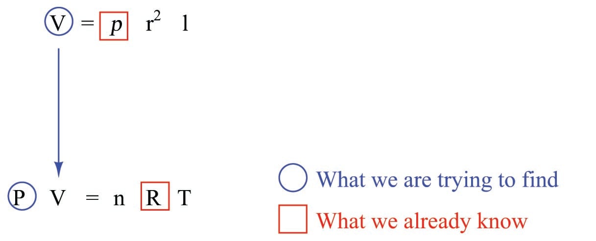

However, the Ideal Gas Law formula contains no variable \(x\) to represent piston position. Somehow, we must find a way to relate \(x\) to the Ideal Gas Law formula in order to progress to a solution for this problem.
The first step in applying this formula is to identify which variables are given to us in the problem, and which we need to solve for. In order to solve for the value of any one variable in an equation, there cannot be any other unknown quantities – this is a basic law of algebra.
In this case, the variable we’re ultimately trying to solve for is pressure (\(P\)). The only other quantity found in the Ideal Gas Law formula that we know the value of at this point is \(R\), which is a natural constant. \(V\), \(n\), and \(T\) are all unknown to us at this point in time. Once we do know the values of these three variables, we may algebraically manipulate the Ideal Gas Law formula to solve for \(P\).
Once again we will begin by “marking up” the formula by drawing a circle around the variable we wish to solve for, and drawing squares around any variables or constants for which we already know the values. Any variables left unmarked (i.e. not enclosed in a circle or a square) are unknown quantities which we must determine before we can solve for the circled variable:
This first step of identifying known and unknown quantities is critically important to the process of problem-solving, because it directs us to what we need to do next. An obstacle so many students and professionals alike experience is paralysis in problem-solving: they get part-way into solving a problem and encounter a point where they have no idea what to do or where to go next. This is why having a strategy to identify the next step is so vitally important.
After identifying these unknown variables of \(V\), \(n\), and \(T\), we now know we need to either find other formulae to solve for those values, or investigate the real mechanism to see if we may directly measure their values.
It should be clear that temperature (\(T\)) is one of those variables we should be able to directly measure in the mechanism. We know in order to solve for pressure (\(P\)) given piston position (\(x\)), one of the real-world parameters we must first measure is temperature.
It should also be clear that volume (\(V\)) is a variable related to piston position (\(x\)), and as such we should be able to identify a formula relating the two, which we may then combine with the Ideal Gas Law formula to arrive at one step closer to our solution. Since the interior volume of the machine’s cylinder is, well, cylindrical, we know that the formula for calculating the volume of a cylinder is what we need to incorporate next:
\[V = \pi r^2 l\]
Where,
\(V\) = Volume of cylinder
\(\pi \approx\) 3.1415927
\(r\) = Radius of cylinder
\(l\) = Length of cylinder
As we did with the Ideal Gas Law formula, our next step is to identify in the cylinder volume formula those quantities we currently know versus those we don’t (and therefore those we need to find). Marking up the formula with circles and squares is helpful, as is drawing an arrow between the variable we’re trying to solve for with the cylinder formula and where it goes in the Ideal Gas Law formula. This arrow visually links the two formulae together, showing us where we will eventually need to perform algebraic substitution:
Pi (\(\pi\)) of course is a natural constant, just like \(R\), so we enclose it in a square to show that we know its value. \(r\) is the radius of the cylinder, which in the mechanism’s case is the same as the radius of the piston. As with temperature, this is a quantity we will need to determine in order to solve this problem. Length (\(l\)) is exactly the same as the piston position given to us in the problem: \(x\), meaning we may re-write the cylinder volume formula as \(V = \pi r^2 x\). Representing all of these relationships graphically:
The only unknown still existing is \(n\), the number of moles of gas held inside the cylinder. This is not something one would be able to directly measure, like temperature, piston radius, or piston position. Either this is a quantity that would have to be provided to us as a given condition in the problem, or we must know something else about the problem in order to find the value of \(n\). We will set aside this issue for the time being and concentrate for now on how to combine the cylinder and Ideal Gas Law formulae.
As our graphical markup of the two formulae show us, volume (\(V\)) calculated by the cylinder formula is what gets “plugged in” to the Ideal Gas Law formula (\(V\) as well). In algebra, this operation is called substitution: replacing a single variable in an equation with another equation.
\[\hbox{Substituting} \hskip 10pt V = \pi r^2 x \hskip 10pt \hbox{for} \hskip 10pt V \hskip 10pt \hbox{in} \hskip 10pt PV = nRT \hskip 10pt \hbox{. . .}\]
