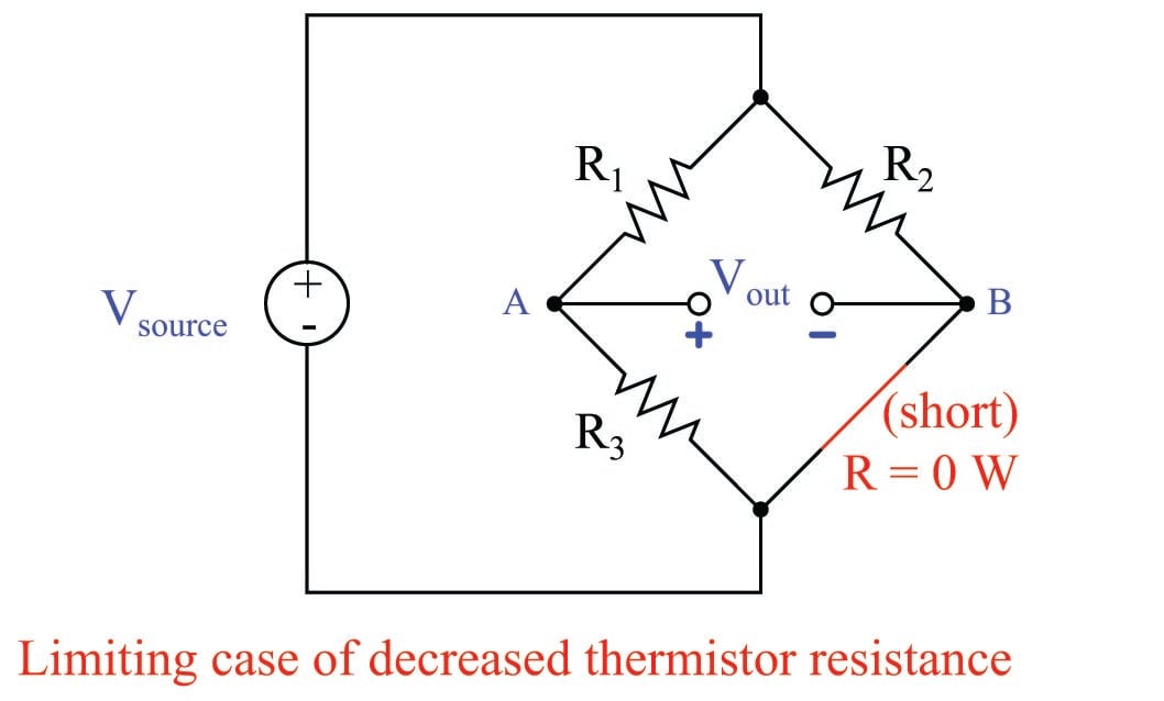

Another realistic question to ask of this circuit is, “what will happen to \(V_{out}\) when the thermistor’s resistance decreases?” Once again, the problem-solving technique of limiting cases helps us by transforming the four-resistor bridge circuit into a three-resistor bridge circuit. The limiting case of a resistance decrease would be a condition of no resistance: a shorted thermistor:
With the thermistor shorted in this “thought experiment,” we see that test point B now becomes electrically common with the negative terminal of the voltage source. This, of course, has the effect of making test point B as negative as it can possibly be. More specifically, by making test point B electrically common with the bottom node of the bridge, it makes \(V_{out}\) equal to the voltage drop across \(R_3\). Thus, the limiting case of \(V_{out}\) for a decrease in thermistor resistance is \(V_{R3}\), with A positive and B negative.

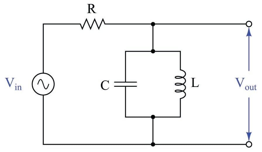

Let us consider another application of this problem-solving technique, this time to the analysis of a passive filter circuit:
If the type of filter circuit shown here were unknown (i.e. the student could not identify it as a low-pass, high-pass, band-pass, or band-stop filter circuit at first sight), the technique of limiting cases could be applied to determine its behavior. In this case, the limit to apply is one of frequency: we may perform “thought experiments” whereby we imagine the input frequency being extremely low, versus being extremely high.
We know that the reactance of an inductor is directly proportional to frequency (\(X_L = 2 \pi f L\)) and that the reactance of a capacitor is inversely proportional to frequency (\(X_C = {1 \over {2 \pi f C}}\)). Therefore, at an extremely low frequency (\(f =\) 0 Hz), the inductor will act like a short while the capacitor acts like an open:

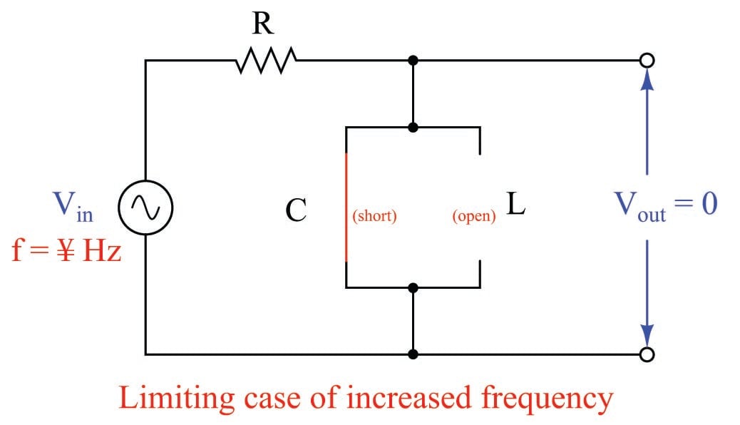

Likewise, at extremely high frequencies (\(f = \infty\)), the capacitor will act like a short while the inductor acts like an open:
From these two limiting-case “thought experiments” we may conclude that the filter circuit is neither a low-pass nor a high-pass, because it neither passes low-frequency signals nor high-frequency signals. We may also conclude that it is not a band-stop filter, because that would pass both low-frequency and high-frequency signals. This means it must be a band-pass filter, by eliminating the other three alternatives.
If we would wish to confirm the band-pass nature of this filter by a positive experimental result rather than merely by eliminating what it is not, we could perform one more limiting-case “thought experiment:” a condition where the signal frequency exactly equals the resonant frequency of the LC network (\(f = {1 \over 2 \pi \sqrt{LC}}\)). Here, we must recall the principle that a parallel LC network has infinite impedance at its resonant frequency:
In this “thought experiment” we see that the LC network will be completely “open” and allow 100% of the input signal to appear at the output terminals. Thus, it becomes clear that this passive circuit functions as a band-pass filter.
