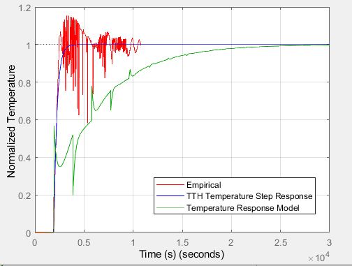

Currently, our PID controller is set to Kp = 4, Ki = 4, Kd = 0. Clearly there is some overshoot, and because the process is so slow and delicate, it is not in our best interest to use trial and error to figure out the best parameters. Below is a plot I created in MATLAB to try and model our plant. The empirical data is normalized (TT-132 "Triple tube heater temp"/Set point) and shows many oscillations. Note the time (in seconds).. the initial rise time is approx. 10 minutes.

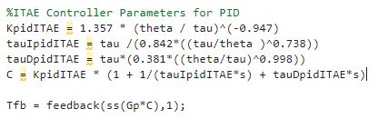

The empirical plot includes the current controller settings (p = 4, i = 4, d = 0) during a start up period. The blue graph is a first-order-plus-deadtime representation of the heat exchanger (taking 't' at 28.3 % and 63.2% of the final value then finding tau/theta to create a transfer function as the plant model). The following is the code used to execute the green plot, which is my attempt at using an ITAE PID controller alongside the calculated transfer function.
Obviously this response isn't exactly desirable for our system.. I want to remove the overshoot (from 220 degrees F to our setpoint of 200 degrees F) without the risk of using a trial and error method. Am I modelling this plant properly? What is a strategy I could employ that I could use to create an accurate plant model? Do IAE/ITAE formulas work for such a slow process? I noticed that the Ti and Td values were fairly large, while Kc was always <1.
