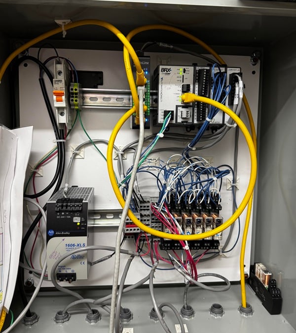

 Figure 2. The compact AutomationDirect BRX PLC fits easily inside a small control enclosure, with Dold relays operating control valves.
A BRX PLC was specified to handle the monitoring and control logic, along with native support for industrial communications protocols. To track the status of incoming water, industrial ProSense 4-20 mA pressure sensors were installed directly on both the well supply line and the incoming city water line, delivering real-time analog data straight to the PLC. A C-more HMI would provide local visualization and remote viewing capability, and it would send email notifications when problems occurred.
To control water connections, the team installed three heavy-duty, stainless-steel dual-solenoid-operated ball valves: one from each water source, and one to flush the city line to drain. Each valve is driven by a pair of Dold force-guided relays sourced from AutomationDirect, ensuring positive relay open/close action and long-term operating reliability. All these components are compact, lending themselves to installation in a small control panel that would be easy for those working on the initial install or troubleshooting in the future.
When the system is operating on well water and a supply failure drops the pressure below a pre-programmed threshold, the PLC notifies the users that they should initiate the transition from well to municipal water. Before connecting the municipal supply directly to the facility, the logic first opens a dedicated valve to flush the city line to drain for a period of time, clearing silt from the system. Once the timing sequence finishes, the PLC closes the flush valve and opens the municipal supply valve to the laundry, while simultaneously closing the well water valve.

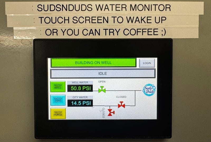

Establishing visibility to the system status and data was the final piece of the architecture.
By pairing the controller with a StrideLinx secure industrial VPN router, the team enabled encrypted cloud connectivity without requiring complex local IT infrastructure changes.
The business owner now has complete operational visibility onsite via the local color touchscreen HMI. The HMI also sends email notifications to the business owner’s team to alert them of any issues. This HMI model also supports remote access using a smartphone application, so the owner can remotely monitor line pressures, adjust pressure setpoints, check valve positioning, override the flushing cycle, and perform other functions.
 Figure 3. An AutomationDirect HMI provides user-friendly local indication and control visualization.
The integration of this small-scale automation system has virtually eliminated downtime caused by water supply interruptions. In the past, a well problem during an unstaffed weekend shift could halt operations for an entire day, leading to hundreds of dollars in lost revenue and significant customer frustration. Now, transitions happen automatically in a matter of minutes, keeping the facility humming along smoothly. The addition of the flushing sequence has prevented sediment from fouling downstream washing machine components, saving money by avoiding the replacement of components and maintenance labor.
