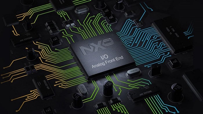

 Figure 2. Analog front ends (AFEs) are a critical building block in the journey from data to insights.
