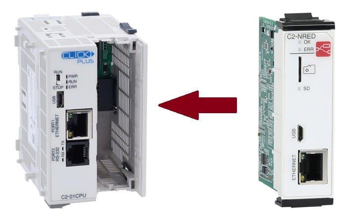

A Node-RED module that plugs directly into a PLC backplane provides an edge computing environment that runs alongside deterministic logic, not as a replacement or an additional burden. It runs a full Node-RED runtime on embedded Linux, providing real-time data flows, cloud connectivity, protocol bridging, and lightweight analytics, all within a familiar PLC form factor that conforms to industrial certifications.
 Figure 1. The C2-NRED module for the CLICK system by AutomationDirect is an example of Node-RED installed directly into the PLC.
Such a PLC module communicates directly over the backplane to exchange plant floor (OT) data with the CPU, while simultaneously connecting to IT enterprise systems, MQTT brokers, or cloud platforms via an onboard Ethernet port. The integrated approach lets small and mid-sized machine builders add genuine edge capability (dashboards, alerting, condition monitoring, OEE calculations, etc.) without the cost and complexity of a separate edge gateway or industrial PC (IPC).

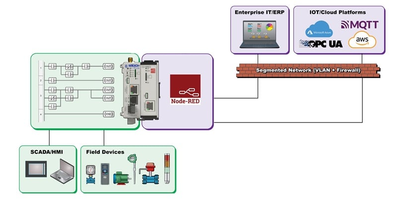

Protocol support often determines whether an edge device can actually connect to the installed base it needs to serve. A machine on a factory floor might need to simultaneously communicate with Modbus RTU sensors, an Ethernet/IP PLC from another vendor, an OPC UA server on the SCADA system, and an MQTT broker in the cloud.
 Figure 3. A Node-RED module provides a platform for integrating OT communication protocols with higher-level IT enterprise and cloud computing platforms.
An edge device acts as a protocol bridge, simplifying the overall system architecture and reading data from field devices before forwarding it to cloud platforms via MQTT or HTTPS. For OEM machine builders whose machines land in varied customer environments, this is a significant practical advantage.
