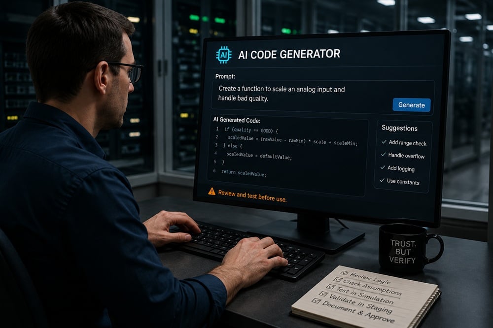

 Figure 3. AI accelerates coding, but engineers must validate the results.
A better prompt should look very different from that simplistic input. It should define all important requirements, including the target programming language, all relevant details about the controller platform, the input and output addresses, and probably much more. Your prompt should also include a narrative of the operating sequence and expected behavior. Many AI models can interpret a diagram if one is available. Finally, include your considerations around permissives, alarms, and failure conditions. In fact, include the entire functional specifications of your project if they are available.
