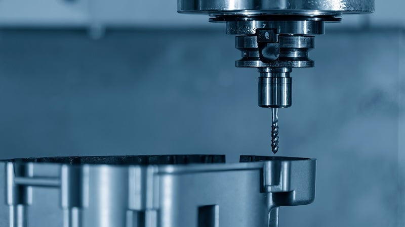

So, here’s a real question you’ll need to consider: What happens when you need to rigid tap a hole and your spindle can’t sync to the Z-axis movement? When that’s the problem, servo motors are the answer.
Rigid tapping demands that the spindle and the Z-axis move in perfect coordination. Every rotation of the spindle must match the axial feed, down to the exact thread pitch. Try doing that with a basic setup or an open-loop system, and you’re in trouble. Threads come out inconsistently, taps break, and you waste parts. A more basic stepper motor simply cannot keep up.
 Figure 1. Thread tapping requires extreme precision and coordination between z-motion and rotation speed.
Figure 1. Thread tapping requires extreme precision and coordination between z-motion and rotation speed. Image used courtesy of Adobe Stock
With a servo spindle and an encoder, the machine knows exactly where the spindle is at every moment. It can reverse precisely at the bottom of the hole and follow the same thread path back out. No floating tap holder needed, no guesswork, no compromise. Just tap, reverse, and done. Fully automated.
So, are servos worthy of consideration? If you want to run production-level threading with no headaches, they’re not just valuable, they’re essential.

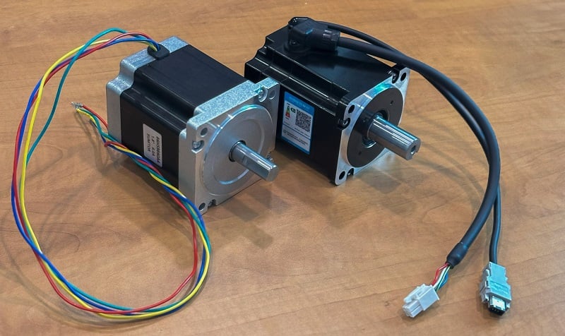

Why Do Servo Motors Outperform Stepper Motors in CNC Applications?
Servo motors outperform stepper motors in CNC work because they’re smarter and faster. Unlike steppers, which move in fixed steps and hope they’re in the right spot, servos constantly check their position using an encoder. This feedback loop enables real-time corrections, resulting in improved accuracy, increased speeds, and smoother motion, particularly under load.
Steppers are ideal for simple tasks and are ideal for beginners or hobbyists. This motor type is cheaper, easy to set up, and provides adequate performance for tasks such as home-based CNC machining, 3D printing, or engraving. Steppers are ideal for working with more basic materials, such as plastic parts, wood signs, or PCB boards. But once you’re cutting harder materials, making tight-tolerance parts, or trying to push faster cycle times, steppers begin to fall short. They can overheat, skip steps, or just not keep up.
 Figure 2. A simple stepper motor (left) vs a servo motor, evidenced by the encoder feedback cable (right).
Figure 2. A simple stepper motor (left) vs a servo motor, evidenced by the encoder feedback cable (right). Image used courtesy of CanCam
That’s where servos shine. You’ll find them in serious industrial wood CNC machines, CNC mills, lathes, plasma cutters, and industrial robotics, where you need speed, repeatability, and real torque. They also generate less heat because they only draw power when needed. That’s a significant advantage in terms of reliability.
If you’re making small parts or prototypes on a budget, steppers are fine. But if you’re running production, cutting metals, or need precision and speed, servos are a better tool for the job.
