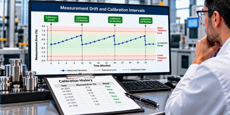

Calibration Intervals Should Be Logical
Another weak point in many calibration programs is the assumption that every instrument should follow the same calendar interval.
A fixed annual interval may be appropriate in some situations, but the interval should have a technical basis. Equipment usage, operating environment, stability history, required measurement performance, manufacturer recommendations, and the consequences of an out-of-tolerance condition can all matter.
Figure 2. Measurement drift over successive calibration intervals can provide evidence for reviewing the frequency of recalibration.
ILAC G24:2022 provides guidance specifically on determining and reviewing recalibration intervals for measuring equipment. The purpose is to help laboratories and other organizations establish calibration programs based on appropriate methods rather than treating the interval as an arbitrary date.
Past calibration results can tell engineers quite a bit about an instrument. One that has remained stable through several calibration cycles presents a different maintenance picture from one that has shown repeated drift. That history does not, by itself, determine the right interval. It does give the organization evidence it can use when reviewing the interval.
That approach also makes better use of automation. A quality system can track calibration results, equipment use, maintenance events, and upcoming reviews. The goal is not to automate calibration decisions blindly. It is to give engineers better information for making those decisions.
