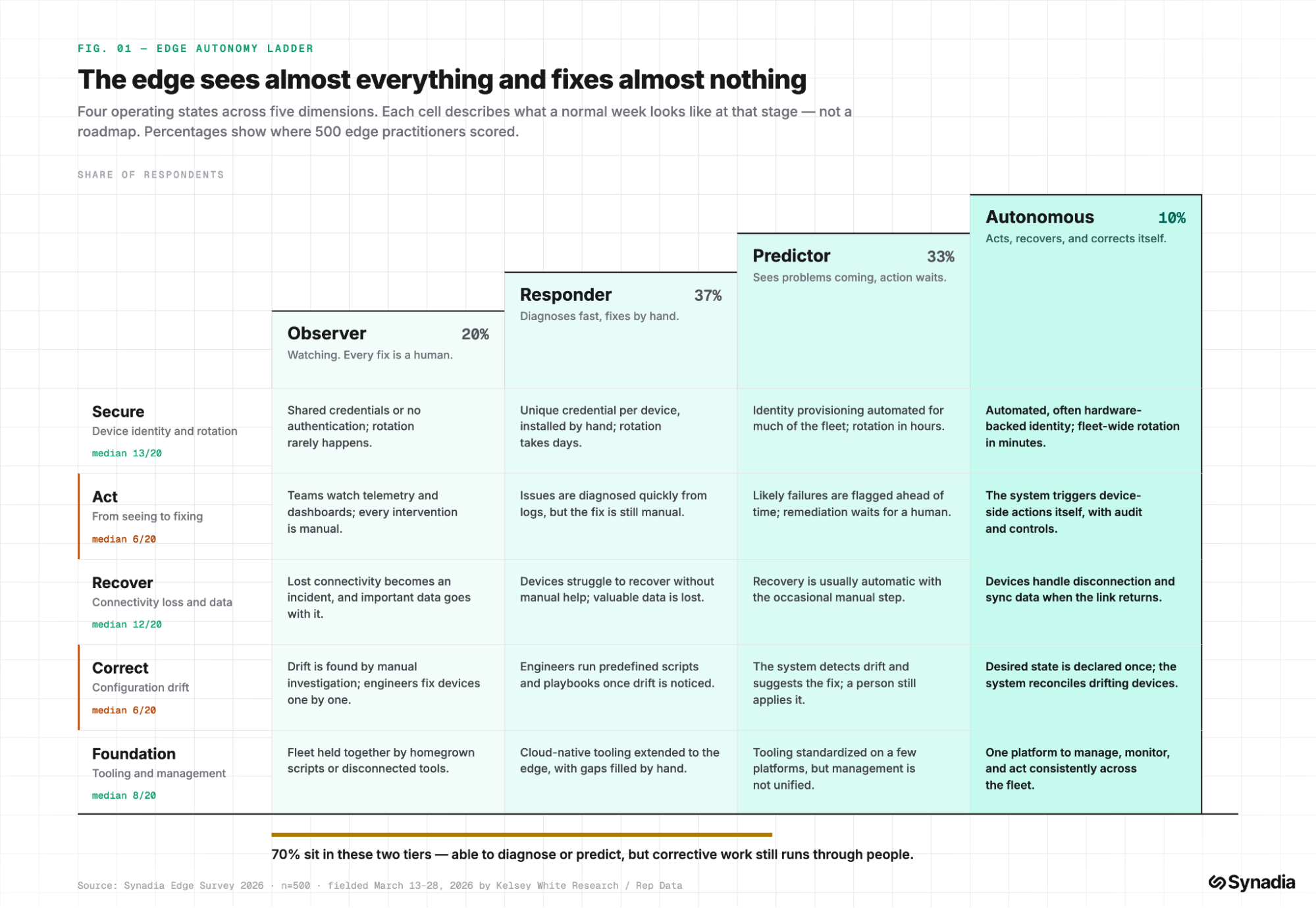

Synadia recently sponsored a survey of 500 edge practitioners to take the pulse on the current state of industry. In this survey, Synadia defined four operating tiers: observer, responder, predictor, and autonomous. The observer tier says a problem can be detected, but a human must fix the problem. The responder tier diagnoses the problem, but a human must fix the problem manually. The predictor tier anticipates a problem and notifies a human, who must still fix the problem manually. In the autonomous tier, the system predicts, detects, identifies, and fixes the problem itself. Across these four tiers are five dimensions: security, act, recover, correct, and foundation.
The results of the Synadia survey, conducted by Kelsey White Research / Rep Data in March 2026, are shown in Fig. 01. Only 10% of respondents were scored in the autonomous tier. This means edge devices are detecting problems, but fixing very few of them.
The real problem is shown in Figure 1: it is easy to detect problems, but much harder to act upon them.
Figure 1. Synadia's classification of survey data across four tiers and five dimensions.
This survey also found that 86% of edge practitioners say that decision-making intelligence will continue to push toward the edge. Another question showed that only 20% of respondents say that their systems have reached closed-loop remediation. Furthermore, only 13% of teams that experience connectivity challenges say their systems can recover automatically when connection is lost.

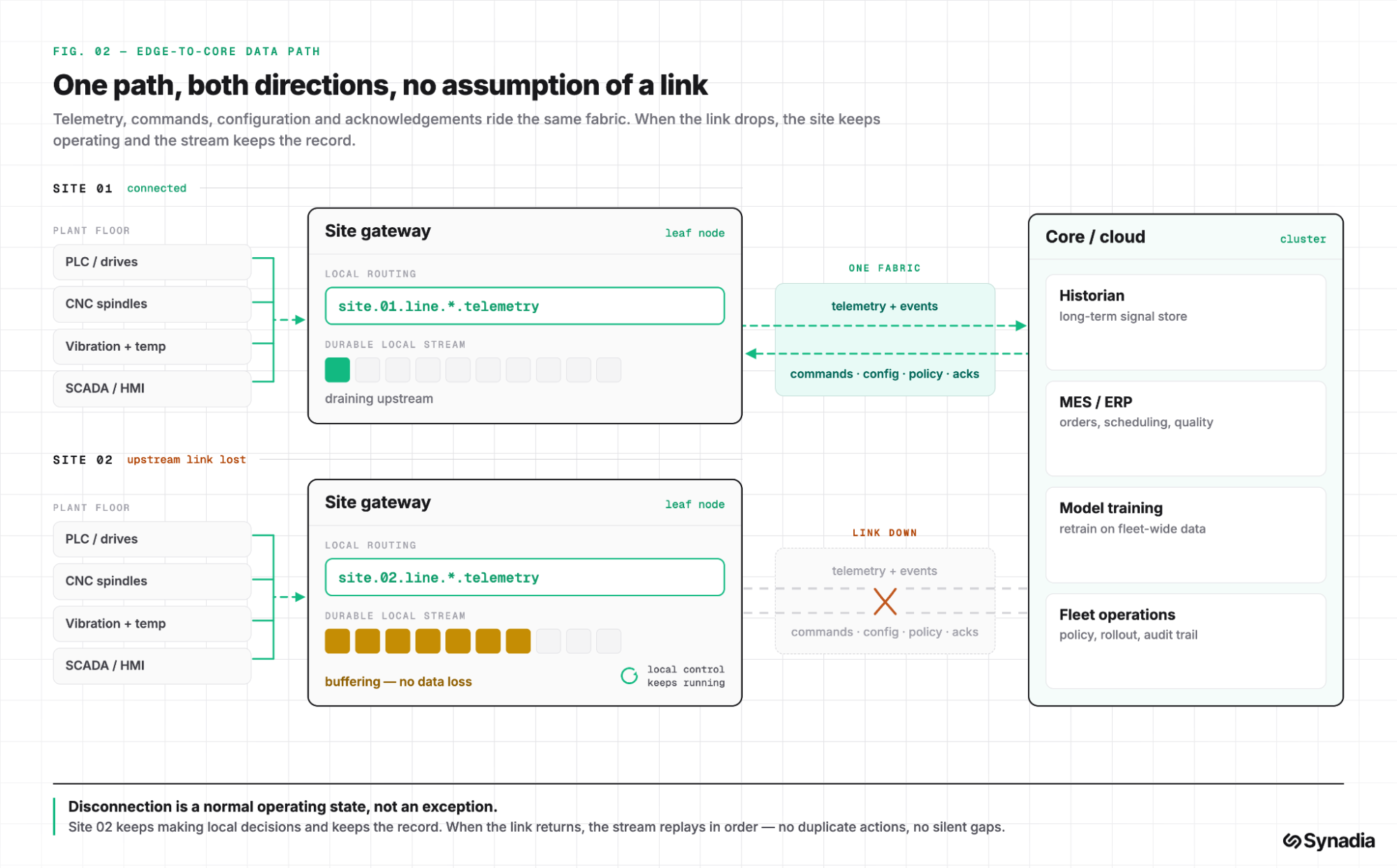

Figure 2 shows Site 01 operation is ideal; the buffer is draining and communication is good. However, communication links drop as shown in Site 02. Site 02 is operating as well: data is buffering and nothing is lost, even though communication has dropped. Designing for these inevitable events is essential to keep a complete, accurate record of data for troubleshooting and auditing purposes.
Figure 2. Two sites, one with a good connection and one without, at this snapshot in time.
Instead of using MQTT as the communications backbone, a server runs at every site, regardless of whether the wide area link is connected or not. Data is collected and stored locally, rather than every piece of data being sent to the cloud. The devices themselves still use MQTT to communicate, but the architecture above them changes.

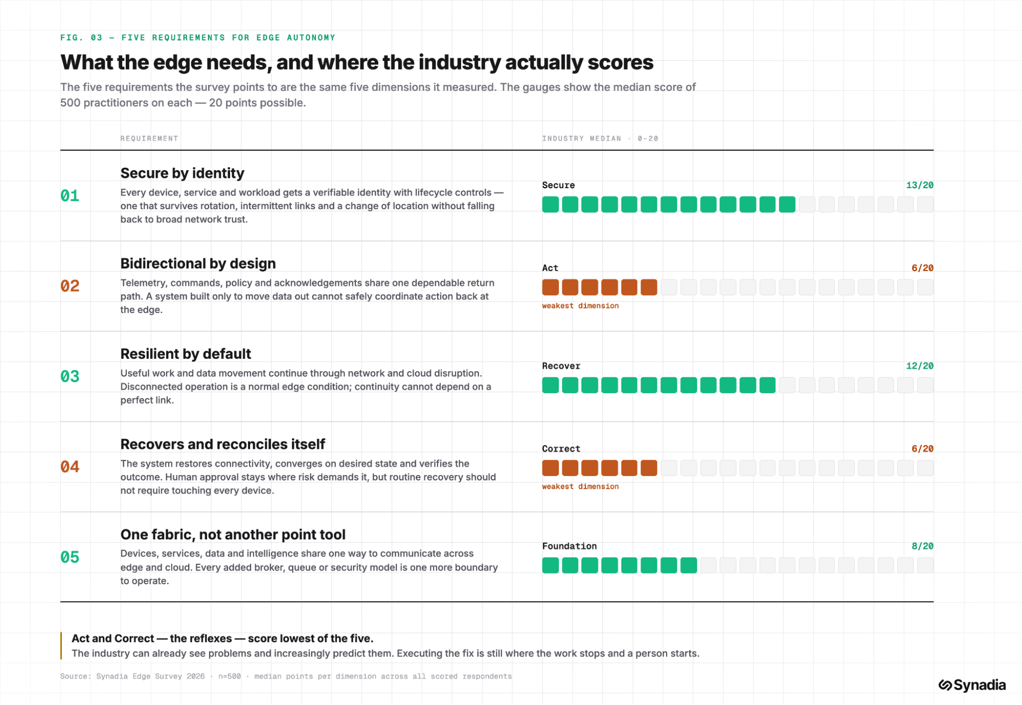

Synadia has identified five key architectural features that help drive true autonomous operation at the edges. Based on the survey data, Synadia listed: secure by identity, bidirectional by design, resilient by default, self-recovering/reconciling, and “one fabric” or not another point tool as important factors in a more robust backbone.
From there, secure by identity means each device has its own identity that does not rely on shared credentials. Bidirectional by design means that one reliable path can handle telemetry, commands, policy, and acknowledgment. Resilient by default means that the system can use a store-and-forward method, even during communication outages. Self-recovery and self-reconciliation mean that a system can course correct after an interruption without needing a human to manually recover the device. The last feature, “one fabric”, not another point tool means that all devices and services share a mechanism to communicate between edge and cloud.
In Figure 3, each of these architectural features was scored out of 20 possible points. This chart represents the median score for each feature.
Figure 3. While security and resilience were higher, bidirectionality and self-correction scores were lower.

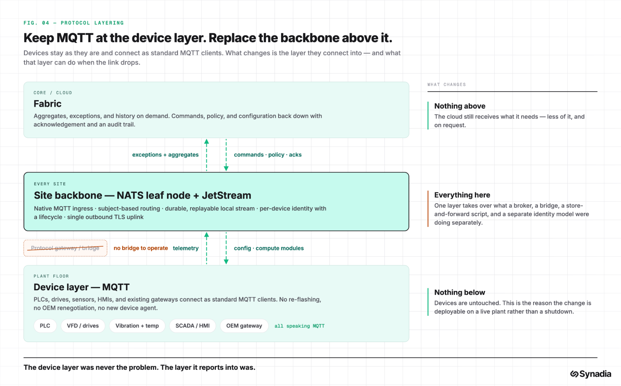

NATS, by Synadia, is an open-source platform that delivers all of these architectural features. Device-level communication is still performed using MQTT. Above the device level, NATS leaf nodes are servers that work locally, regardless of link connections. Communication links are bidirectional, so commands can travel back down to devices. Above the NATS leaf nodes, there is a uniform fabric that binds all of these systems together and allows for communication with the cloud, sending only the proper data there. Figure 4 highlights the NATS architecture.
Figure 4. The NATS architecture, with MQTT at the device level and leaf nodes operating locally beneath a uniform fabric.
