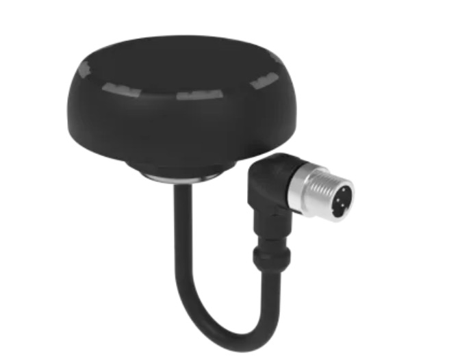

The TouchSafe button has an M12 connector that reduces the need for complex wiring.
The TouchSafe button has an M12 connector that reduces the need for complex wiring. Image used courtesy of IDEM Safety Switches
The new TouchSafe zero-force buttons are equipped with a 90-degree M12 connector that comes pre-wired for simplified installation. The design also offers a clamping provision with its threads and nuts, allowing secure mounting on housing accessories for two-hand operation or surfaces. To further ensure installation flexibility, IDEM offers an adjustable floor stand and a robust metal enclosure as accessories for external mounting and added durability.
For safety, the new capacitive touch solution prevents accidental or one-hand operation, ensuring machine activation only when both hands are simultaneously engaged. To further ensure safety in production tasks, the solution leverages a safety relay that checks through the TouchSafe’s control output if both buttons are touched at the same time. A bright LED indicator around its circular surface offers visual feedback on its activation status.
