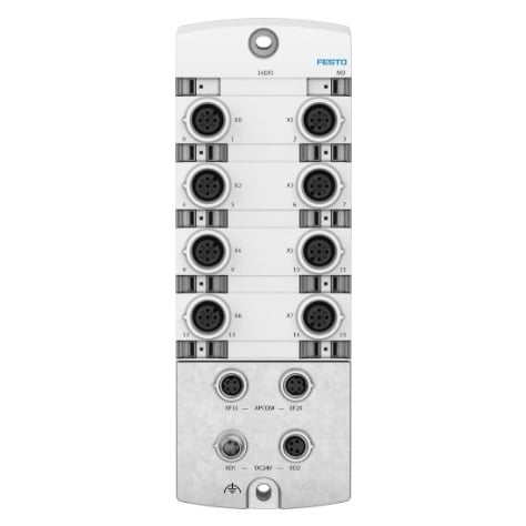

The CPX-AP-I-16DIO M12 provides 16 digital channels that are configurable as inputs or outputs. Engineers can set the module up with a mix of inputs and outputs, such as an 8/8 configuration, or use all 16 channels as outputs. Selected output channels can also provide up to 500 mA for devices with higher current requirements.
Festo’s CPX-AP-I-16DIO-M12-5P provides 16 configurable digital I/O channels in an 8/8 configuration.
Festo’s CPX-AP-I-16DIO-M12-5P provides 16 configurable digital I/O channels in an 8/8 configuration. Image used courtesy of Festo
Festo’s CPX-AP-I-16DIO-M12-5P provides 16 configurable digital I/O channels as an 8/8 configuration. Image used courtesy of Festo. Festo ships the module configured with all 16 channels as inputs, allowing it to be installed in its default state. Output functions are then enabled through software parameterization as needed. Each channel also has its own LED indicator to provide operating and diagnostic information during commissioning and troubleshooting. The M12 version of the module is available now.
The main advantage is reducing the number of dedicated I/O module configurations required for different machines. Instead of stocking separate input, output, and mixed-I/O modules for several designs, the same hardware can be configured differently for each application. This can simplify hardware selection while also making later machine changes easier to accommodate.

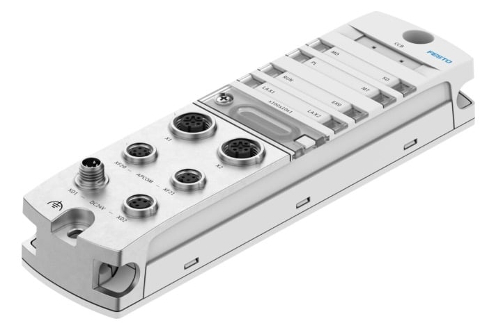

Alongside the configurable I/O module, Festo has also introduced a CPX-AP-I bus node that supports CC-Link IE Field Basic. The addition is primarily intended for machines or companies that use Mitsubishi Electric PLC architectures and provides engineers with a direct way to connect CPX-AP-I decentralized I/O without adding a separate gateway.
Festo’s CPX-AP-I CC-Link IE Field Basic bus node connects the decentralized I/O platform to Mitsubishi Electric control systems.
Festo’s CPX-AP-I CC-Link IE Field Basic bus node connects the decentralized I/O platform to Mitsubishi Electric control systems. Image used courtesy of Festo
The new bus node also enables integrators to maintain consistent CPX-AP-I hardware configurations when adapting equipment for different controls or regional requirements. Engineers can change the network interface while retaining the distributed I/O system used elsewhere on the machine. With the addition of CC-Link IE Field Basic, CPX-AP-I supports industrial Ethernet options including EtherNet/IP, PROFINET, EtherCAT and Modbus TCP.
