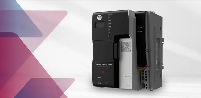

Rockwell Automation’s CompactLogix 5390 controller with local PointMax I/O modules.
Rockwell Automation’s CompactLogix 5390 controller with local PointMax I/O modules. Image used courtesy of Rockwell Automation
The new controller targets machine builders, OEMs, and system integrators working with everything from standalone machines to larger production systems. Along with expanded motion control and data-handling capabilities, the 5390 supports local PointMax I/O and several industrial networking options.

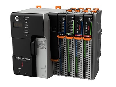

The CompactLogix 5390 controller can support up to 32 local PointMax I/O modules, 128 motion axes, 300 Ethernet/IP nodes, and 4,000 OPC UA nodes.
The CompactLogix 5390 controller can support up to 32 local PointMax I/O modules, 128 motion axes, 300 EtherNet/IP nodes, and 4,000 OPC UA nodes. Image used courtesy of Rockwell Automation
Depending on the model, the controller supports up to 32 local PointMax I/O modules, with standard, safety, and specialty I/O options available. It also supports remote PointMax I/O, allowing engineers to distribute I/O throughout a machine rather than wiring everything back to the main control cabinet.
The 5390 also offers a wide range of configurations to support machines with different motion control, networking, and I/O requirements. Entry-level models support eight motion axes, 60 EtherNet/IP nodes and 300 OPC UA nodes, while higher-end configurations support up to 128 motion axes, 300 EtherNet/IP nodes and 4,000 OPC UA nodes. Standard and safety memory capacities range from 0.4 MB each to 10 MB each. For OEMs building everything from smaller standalone machines to more complicated production systems, that range could make it easier to standardize on the CompactLogix platform without having to change controller families as machine requirements increase.

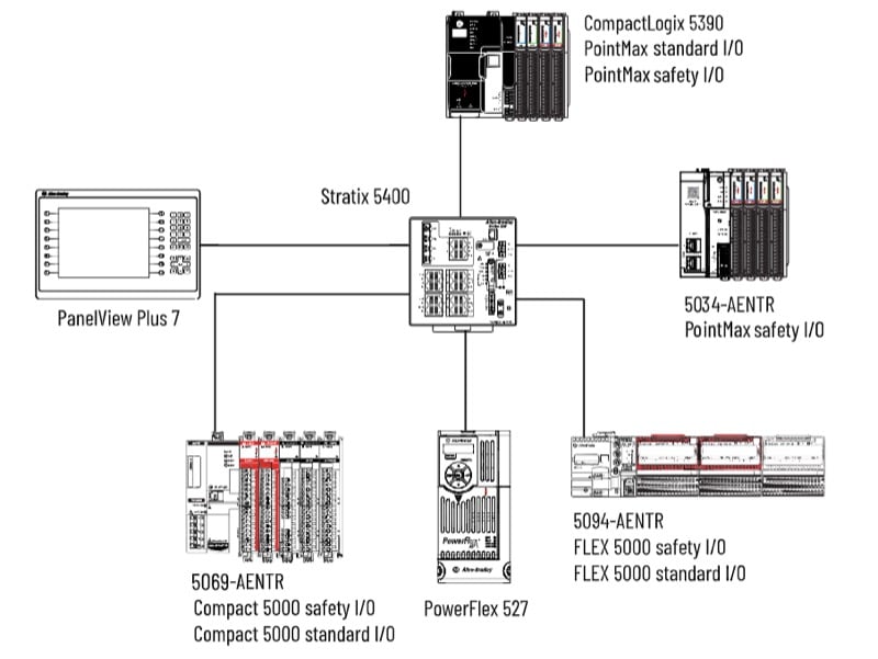

Rockwell Automation's CompactLogix 5390 safety system architecture shows how the controller connects to distributed safety I/O, drives, and operator interfaces through an industrial network.
Rockwell Automation's CompactLogix 5390 safety system architecture shows how the controller connects to distributed safety I/O, drives, and operator interfaces through an industrial network. Image used courtesy of Rockwell Automation
The platform also supports OPC UA, EtherNet/IP, Dual IP, and multiple industrial network topologies. Modern controllers are no longer expected to simply run machine logic. They're increasingly seen as a bridge between machine-level operations and higher-level manufacturing systems. From that perspective, the CompactLogix 5390 feels less like a standard controller refresh and more like Rockwell's attempt to combine machine control, safety, connectivity, and cybersecurity into a platform for increasingly connected manufacturing environments.
