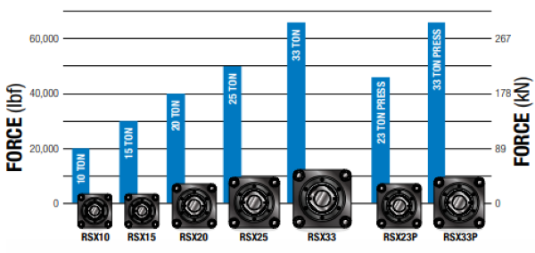

This image clarifies Tolomatic’s RSX actuators' force capabilities, which forms the argument for replacing traditional hydraulic systems.
This image clarifies Tolomatic’s RSX actuators' force capabilities, which forms the argument for replacing traditional hydraulic systems. Image used courtesy of Tolomatic

Although the primary selling point of the newly introduced RSX Electric Linear Actuators is their high-force capabilities, they also have many other specifications that may persuade users to make the switch.
The RSX linear actuators are designed to provide cleanliness and durability. They have an IP67 option to protect against dust and water and a food-grade design option. Users can feel confident that these actuators meet standards for various industries. Additionally, these actuators feature a heavy-duty internal bumper that protects moving components at both ends of the stroke, where wear and tear are commonly compounded. They also have high positional accuracy, with the roller nut capable of ±0.0102mm/300mm and the ball nut ±0.102mm/300mm.
