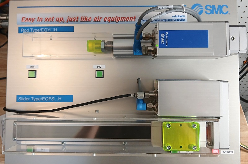

 Figure 1. The e-Actuator series in a demo unit from SMC.
Figure 1. The e-Actuator series in a demo unit from SMC. Image used courtesy of the author

We will use a slider-type EQFS series actuator (special thanks to the SMC team for loaning a sample for bench-testing). These actuators are not free from complex controllers. However, it’s built right into the actuator and automatically handles all the heavy lifting. A glance at the side of the control module shows one M12 input socket for power, a second 8-pin M12 for the digital I/O signals, and a third M12 connection for the PC configuration connection.

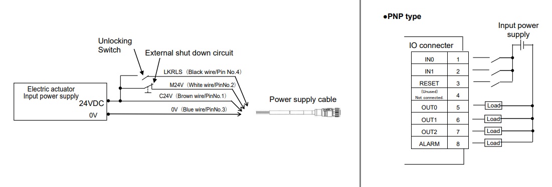

 Figure 3. Pinout for power (left) and for I/O (right).
Figure 3. Pinout for power (left) and for I/O (right). Image modified from SMC product user manual
The power input receives +24 and 0 volts from a DC supply.
The signal input has a few more tricks up its sleeve. First, it is important to note that, unlike PLC input modules, the I/O pins are internally connected to the power supply input. Providing 24 volts to an input pin is sufficient; there is no Com terminal. This also means that the external I/O devices must be supplied by the same power supply as the actuator itself, or at least the 0 V rails must be tied together.
The first two pins are for the signal inputs. This will be very significant in the next step when we talk about the configuration software and the various modes of operation.

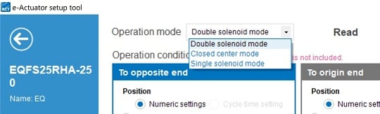

 Figure 4. Operating modes.
Figure 4. Operating modes. Image used courtesy of the author
Operating Modes
There are three different modes, all of which can be driven with just the two digital inputs.
  • Single solenoid mode: energizing IN1 drives the actuator to the far end, then turning it off makes it return to the origin end.
  • Double solenoid mode: energizing IN1 drives the actuator to the far end, then energizing IN0 makes it return to the origin end. Energizing both inputs does nothing.
  • Closed center mode: energizing IN1 drives the actuator to the far end, then energizing IN0 makes it return to the origin end. Energizing both inputs drives it to a center point.

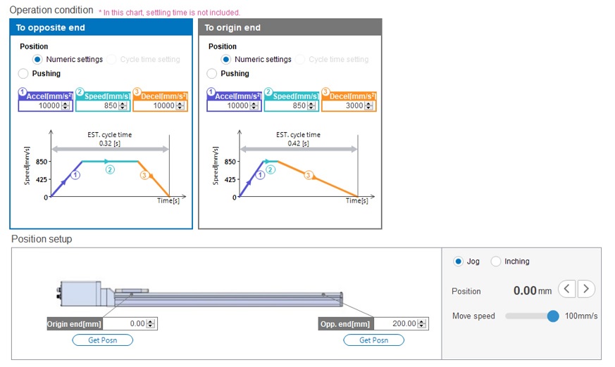

 Figure 5. Position and speed settings.
Figure 5. Position and speed settings. Image used courtesy of the author
Speed and Position Settings
The whole idea is to set up a system that is very simple to operate, but that doesn’t mean we can’t configure some of the motion.
First, we can select the speed profile for both directions of motion. Speed profile includes accel, top speed, and decel. It will automatically calculate the total travel time based on these speeds and the stroke length.
Speaking of the length, we can also set the position of the opposite and origin end; it doesn’t need to move all the way to hardware limits. We can also choose the exact intermediate position for the center closed mode.
When the operating mode, speed, and position parameters are set, you can save the data to the device.
