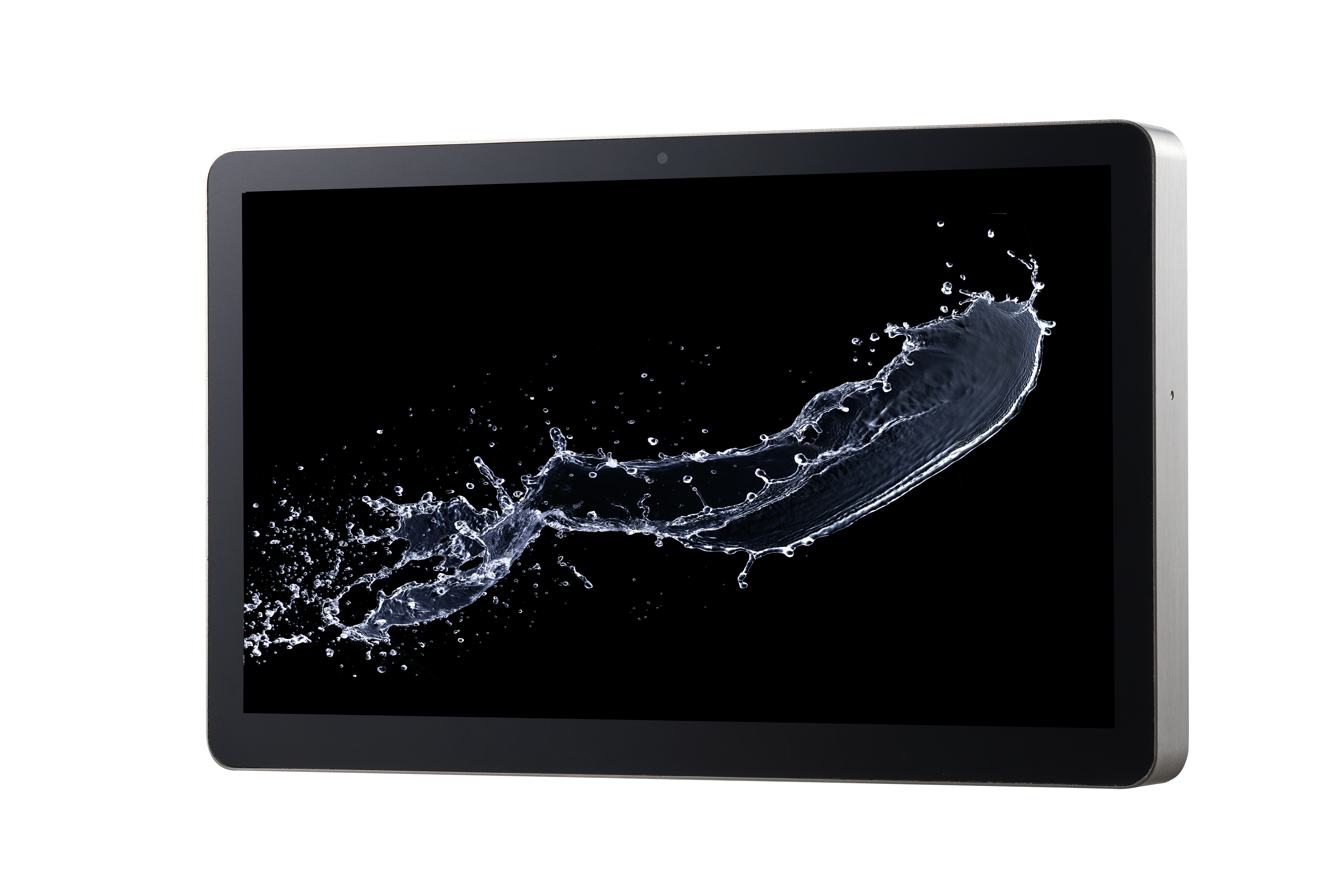

The Titan2’s full high-definition (FHD) display brings out color and fine details
The Titan2’s full high-definition (FHD) display brings out color and fine details. Image used courtesy of Adlink

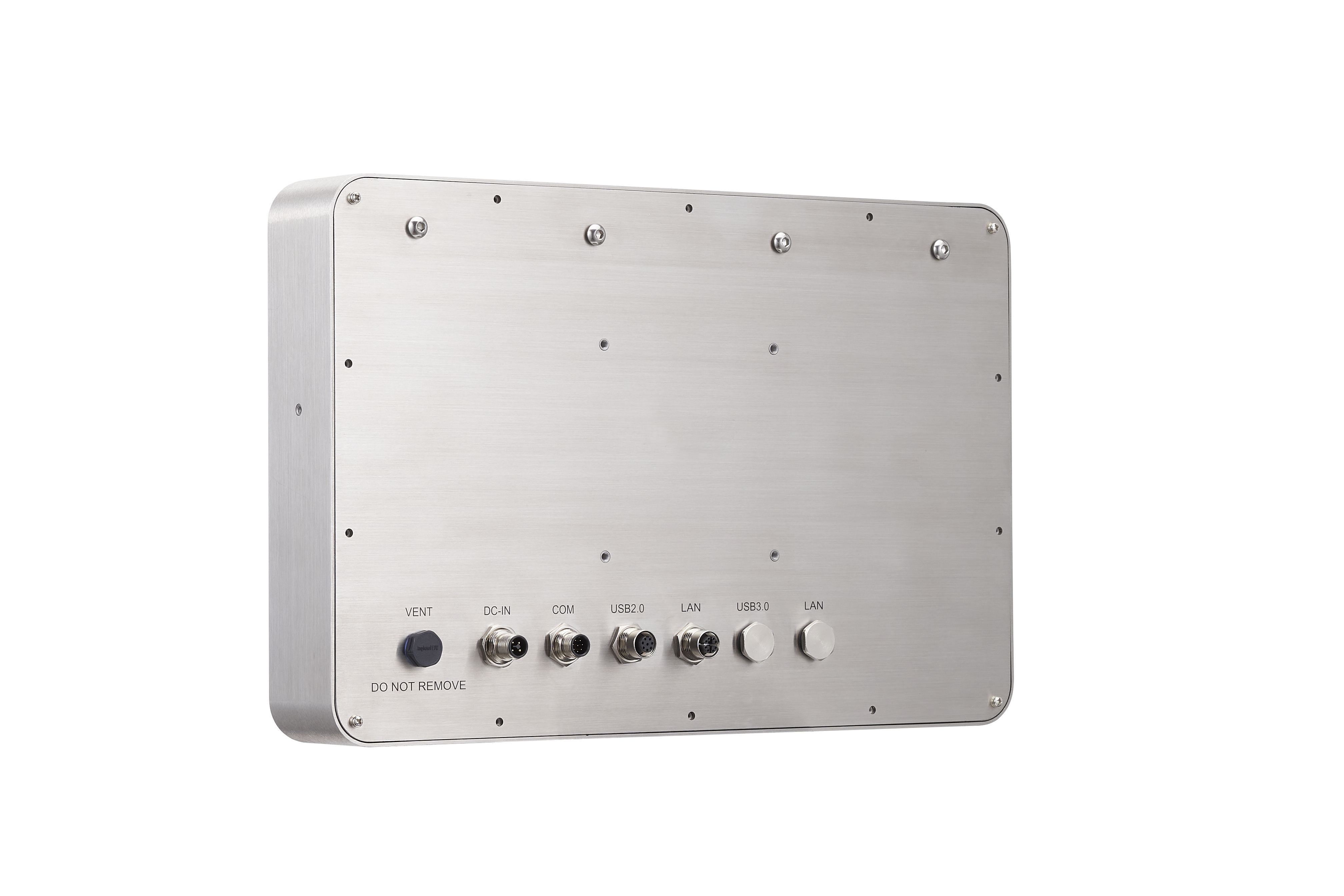

The Adlink IP69K Titan2 Panel PC features an 11th-generation Intel i5/i3 BGA-type processor, making it capable of handling complex code. Three display options (15.6-inch, 21.5-inch, and 23.8-inch) are available so that the PC can be used to drive large dashboard displays for reading across the room or compact options for single-machine control.
The ruggedness of this PC cannot be understated. It can be cleaned with an alcohol wipe, as one might expect. However, it can also be cleaned using high-pressure hot water for a deep, hygienic clean required for food and beverage and pharmaceutical manufacturing. Imagine blasting a standard laptop with high-pressure hot water!
Blast away the Titan2 with high-pressure, high-temperature water for easy cleaning
Blast away the Titan2 with high-pressure, high-temperature water for easy cleaning. Image used courtesy of Adlink
