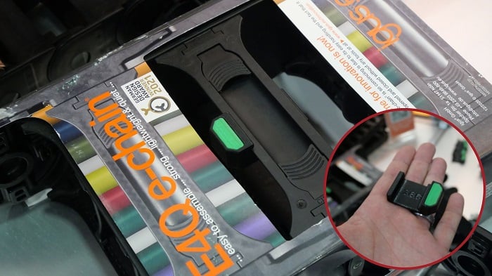

Speaking of drag chains, one innovation stood out from the rest, not because of some remarkable sensor or network integration, but actually, because of the exact opposite.
The e4q e-chain was featured in one display. This is a tough, easy-to-install series, designed for unsupported lengths and long travel distances, and a tool-free opening mechanism. These drag chains, being plastic, are often subject to mechanical wear, failing after many, many hours of motion. Drag chains can be visually inspected or simply replaced at certain service intervals.
However, this lineup features an impressively simple add-on: a small plastic clip with green, yellow, and red plastic inside, shown in the inset of the image below. The device starts green, and as it wears, it will turn yellow, then red, indicating the drag chain condition to technicians at a glance. No more risky guessing, lengthy inspection times, or unnecessary replacement schedules!
A user-friendly drag chain featuring the simple plastic wear indicator device.
