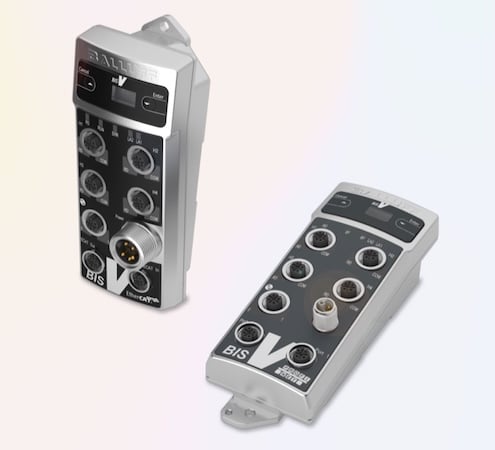

Efficient data transfer is critical for modern smart factories, and Balluff’s BIS V multi-frequency RFID processors are designed to deliver. Supporting low, high, and ultra-high frequency readers, the processors enable centralized management, streamlined commissioning, and integration with MES, ERP, and cloud applications via MQTT and REST API. With loop filters, rugged IP65 housing, and PowerScan connectivity, BIS V enhances reliability in demanding environments while cutting costs, reducing system complexity, and accelerating RFID deployments.
Balluff’s BIS V multi-frequency RFID processors feature four ports with independent parameter setup for linking four readers.
Balluff’s BIS V multi-frequency RFID processors feature four ports with independent parameter setup for linking four readers. Image used courtesy of Balluff

Balluff’s BIS V multi-frequency RFID processors also feature PowerScan connectivity, provisioning customers with RFID and barcode reading functionalities in a single unit for industrial applications across logistics, warehousing, and manufacturing. Specific tasks might include tracking goods, managing inventories, and error-proofing. Balluff’s RFID processors also offer loop filters to pre-process and filter data, reducing noise and interference to ensure more consistent and reliable RFID read processes. Loop filters are typically used to commission and implement UHF RFID systems.
Other benefits
Overall, Balluff’s BIS V multi-frequency RFID processors provide more streamlined MES/ERP integration and device/processor configuration with MQTT/REST API and an intuitive graphical user interface. Further, users can access common bus systems (Profinet, Profibus, EtherCAT, EtherNet/IP, etc.) and utilize a built-in IO-Link master port for linking sensors and actuators, eliminating the need for extra I/O modules and reducing system complexity, as well as component costs.
Balluff’s multi-frequency processors also feature zinc die-cast housing with an ingress protection rating, IP65, making them dust-tight and resistant to water jet sprays from any direction. This protection level ensures that the processors can withstand harsh industry environments. Further, direct mounting reduces cable runs and installation overhead.
