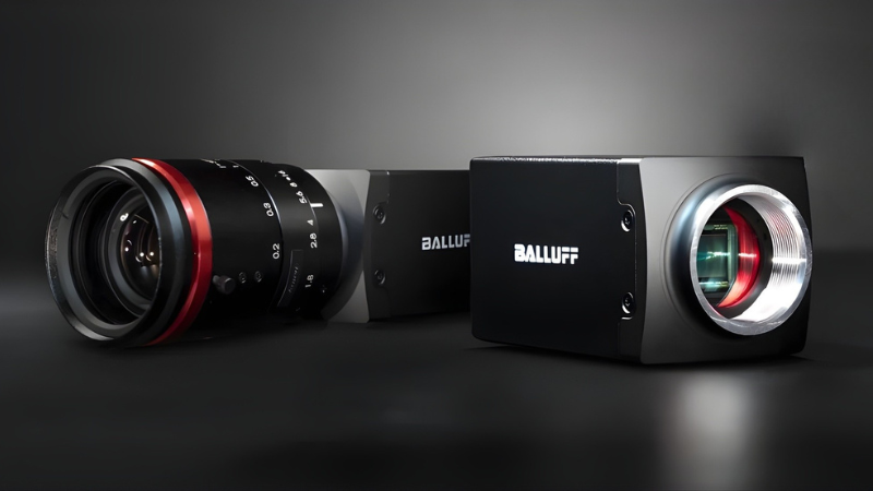

To meet the growing demand for high-performance vision, Balluff has released a 25GigE industrial camera that features a resolution of 24.6 MP.
Balluff’s new 25GigE industrial camera is available in over 20 models with resolutions ranging from 5.1 MP to 24.6 MP
Balluff’s new 25GigE industrial camera is available in over 20 models with resolutions ranging from 5.1 MP to 24.6 MP. Image used courtesy of Balluff
