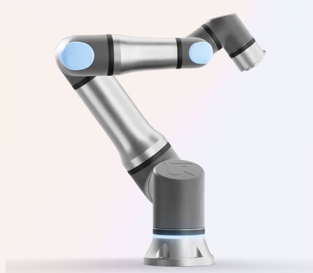

The UR18 robot features an 18 kg payload capacity suitable for larger end effectors.
The UR18 robot features an 18 kg payload capacity suitable for larger end effectors. Image used courtesy of Universal Robots
UR18
The UR18 robot weighs 39.2 kg and offers customers a payload capacity of 18 kg and a 950 mm reach. This robot is also lighter than the majority of other industrial bots with similar payloads. This facilitates easy installation and mounting on conventional gantry systems. With a motion capacity of 4 m/s, customers can leverage UR18’s speed, mountability, compact form, and advanced safety functions to optimize process efficiencies, increase throughput, economise on valuable floorspace, and reduce installation costs.

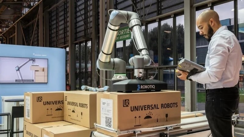

All UR robots are designed to meet strict safety requirements to enhance safety and instill trust in human co-workers working alongside them.
All UR robots are designed to meet strict safety requirements to enhance safety and instill trust in human co-workers working alongside them. Image used courtesy of Universal Robots
