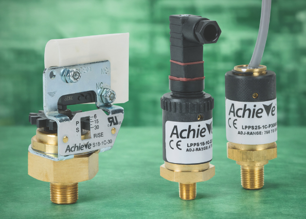

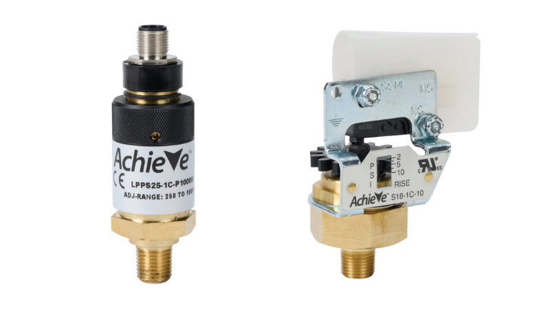

AutomationDirect has released two new mechanical pressure switch series: the AchieVe LPPS and S18-C
AutomationDirect has released two new mechanical pressure switch series: the AchieVe LPPS and S18-C. Image used courtesy of AutomationDirect
AchieVe Mechanical Pressure Switches
AutomationDirect’s new mechanical pressure switches are split into two series. The AchieVe LPPS series supports higher pressure ranges from 2 psig up to 3000 psig, with a 5A SPDT relay rated at 125 VAC (3A at 30 VDC), allowing direct load switching without external relays.
The AchieVe S18-1C series targets lower ranges from 3 psig to 120 psig and increases switching capacity to 10A at 125/250 VAC (5A at 30 VDC), making it more suitable for directly switching higher current devices in lighter-duty systems.
Both the LPPS series (left) and the S181C series (right) feature a brass housing, with either a BUNA-N diaphragm or a hardened steel piston
Both the LPPS series (left) and the S181C series (right) feature a brass housing, with either a BUNA-N diaphragm or a hardened steel piston. Image used courtesy of AutomationDirect

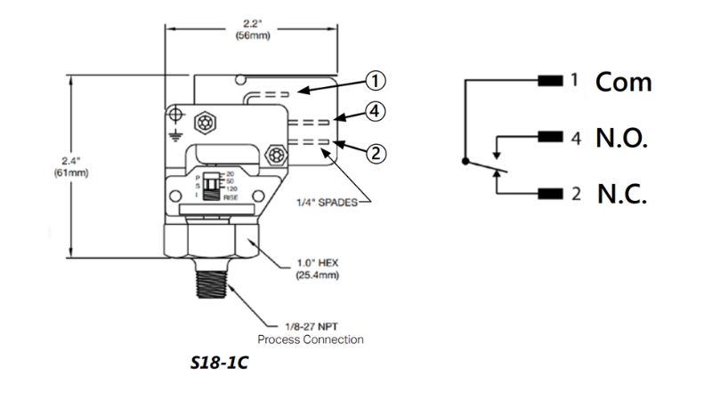

Each model includes M12 electrical connections, DIN-style connectors, and cable leads, while process connections are available in 1/8-inch and 1/4-inch NPT. The built-in SPDT relay simplifies wiring by enabling direct switching without additional components.
Typical electrical connections for the S18-1C
Typical electrical connections for the S18-1C. Image used courtesy of AutomationDirect
