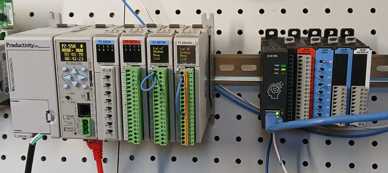

 Figure 2. Productivity2000 PLC and SLM I/O system.
Figure 2. Productivity2000 PLC and SLM I/O system. Image used courtesy of the author
Just like in the Rockwell environment, no device needs to be added to the hardware configuration, and no EDS or Ethernet device config is necessary - you only need the IP address of the SLM-MX.

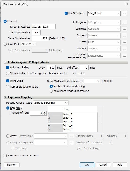

Modbus Read (MRX) is a structure-type tag, so you need to provide the following:
  • The IP Address of the SLM-MX bus coupler.
  • A structure name, like SIM_Module (since my module is a simulator input card with little toggle switches)
  • Check the Automatic Polling button unless you have input logic to provide rising edges. In my example, I increased the polling time to 500 milliseconds, since I do not need high speed. Plus, it makes the whole problem far more exciting later.
  • Set the Starting Address to 1, since the first address in our SLM system is 100001.
  • The Function Code for reading multiple inputs is Code: 2.
  • Create 8 non-array tags and give them logical names. Input_1 through Input_8 seemed like a reasonable assignment to me.
 Figure 3. Productivity Suite Modbus Read (MRX) instruction parameters.
Figure 3. Productivity Suite Modbus Read (MRX) instruction parameters. Image used courtesy of the author

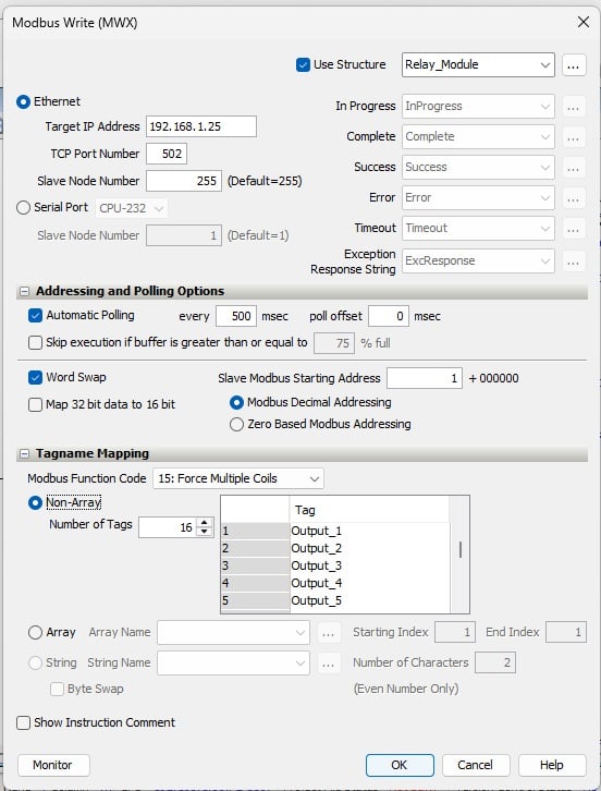

The Modbus Write (MWX) instruction is virtually identical except that we will use Function Code 15 for multiple coils, and this is a 16-terminal relay output card, so make 16 non-array output tags.
 Figure 4. Productivity Suite Modbus Write (MWX) instruction parameters.
Figure 4. Productivity Suite Modbus Write (MWX) instruction parameters. Image used courtesy of the author

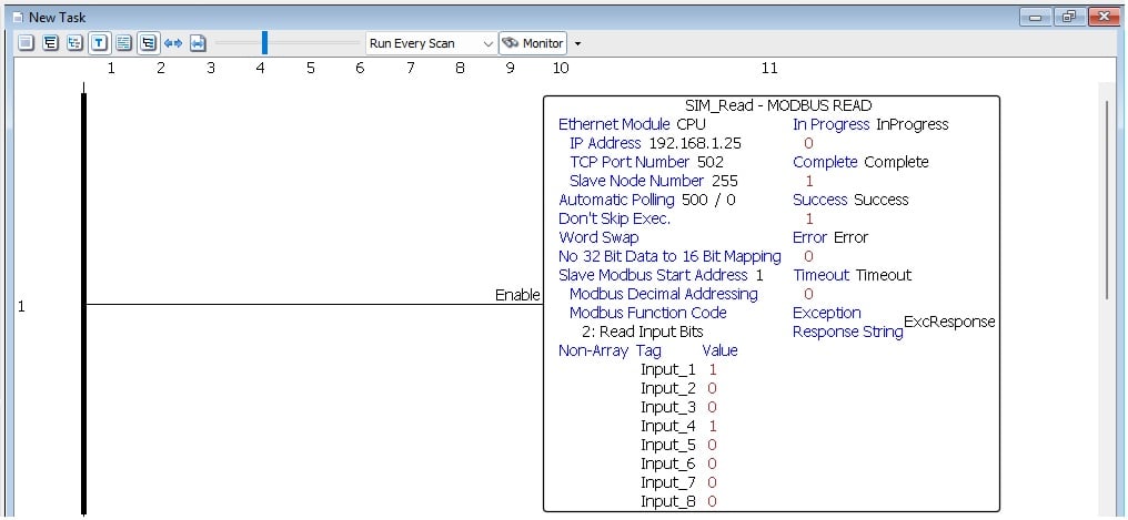

At the top of the ladder programming screen, press Monitor (the binocular icon). When you switch the inputs on and off over at the SLM simulator card, you should see the tag values reflected in the Modbus Read command!
 Figure 5. Monitoring the results of a Modbus Read instruction.
Figure 5. Monitoring the results of a Modbus Read instruction. Image used courtesy of the author
Switch over to the Rockwell platform, and verify that the tags also update at the same time.
This means that we can read information from one I/O system on two different controllers! Now, one can support logic, and the other can support an IIoT connection, or two separate machine centers can both read from one single infeed conveyor system!

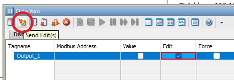

But now, we’re going to flip to the outputs. In the Productivity environment, you can add some logic to drive the output tags, or add them to the Data View tab, check the Edit box, and Send Edits.
 Figure 6. Sending a TRUE value to a digital output.
Figure 6. Sending a TRUE value to a digital output. Image used courtesy of the author
What do you hear?
Well, for me, since the CompactLogix is telling Output_1 to turn OFF, and now the Productivity is telling Output_1 to turn ON, they are fighting.
Since the poll rate of both is 500 ms, this output is clicking on and off like crazy! Sometimes it’s random, sometimes it’s a regular, half-second click. But either way… NOT GOOD.
Figure 7. Watch and listen (unmute) to the behavior of conflicting Modbus commands. Video used courtesy of the author
