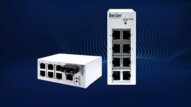

Beijer Electronics, commonly known for its HMI panels, SCADA systems, and cloud computing solutions, has recently replaced its existing JetNet 3008 series of Ethernet switches with the JetNet 2208 series. The new series of Ethernet switches is designed for industrial automation applications, such as connecting field I/Os, transmitters, HMIs, and PLCs. The 2208 series is available in three models, all featuring eight ports to connect multiple devices to an industrial network.
The JetNet 2208 Ethernet switch series will replace Beijer Electronics’ earlier JetNet 3008 series.
The JetNet 2208 Ethernet switch series will replace Beijer Electronics’ earlier JetNet 3008 series. Image used courtesy of Beijer Electronics
JetNet 2208-T8
The JetNet 2208-T8 model features eight 10/100 base TX ports with MDI/MDI-X, a compact IP30 metal housing, and supports 12/24/48 VDC power with operating temperatures of -40 to 75 °C. The T8 model is unmanaged, so no complex configuration is required.

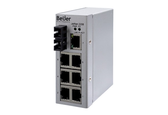

JetNet 2208-T7-SC1-MM
If your applications require longer distances between switches, the JetNet 2208-T7-SC1-MM might fulfill your needs. The T7 model consists of the same compact, rugged housing as the T8 model, only the ports use 100 base-FX fiber transmission lines, allowing cable lengths up to 2000 m. The SC1-MM model is a multimode switch that supports using larger multimode fiber optic cables and has multiple light channels. Similar to the T8 model, the SC1-MM is an unmanaged switch.
Beijer Electronics’ JetNet 2208-T7-SC1-SM unmanaged fast Ethernet fiber switch (single-mode).
Beijer Electronics’ JetNet 2208-T7-SC1-SM unmanaged fast Ethernet fiber switch (single-mode). Image used courtesy of Beijer Electronics
If your application requires high-bandwidth and low attenuation connectivity, the 2208-SC1-SM is the same as the SC1-MM, but only in single-mode fiber connection. You get the same eight fiber optic ports to support fast Ethernet connection, only with the SM model you can take advantage of the single-mode cable, which allows for high speed and high bandwidth over a long distance.

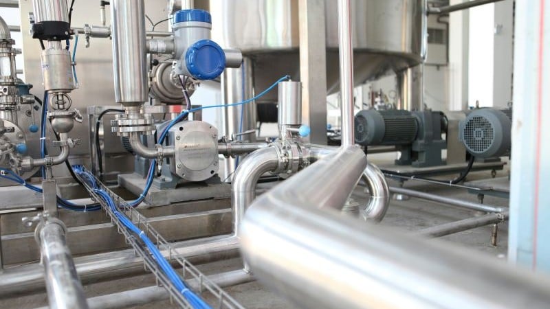

Process field devices using industrial networks to communicate
Process field devices using industrial networks to communicate. Image used courtesy of Unsplash
