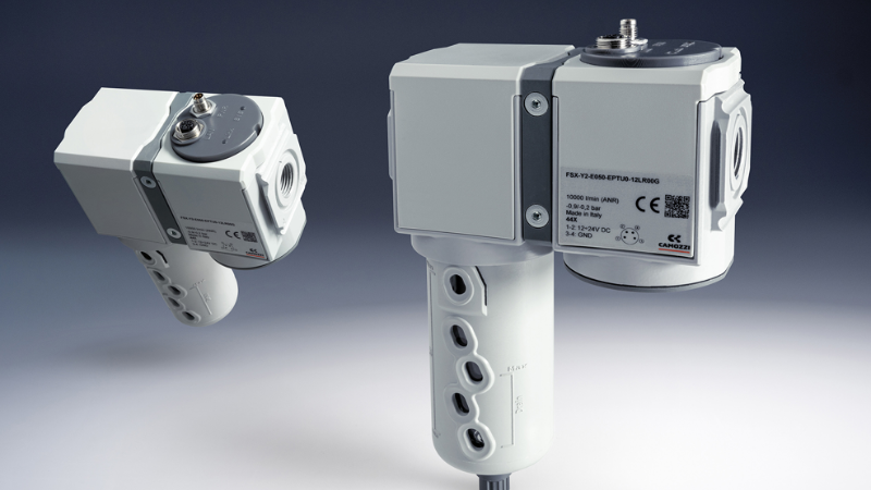

Camozzi has built its new FSX series of smart flow sensors to give manufacturers a clearer view of what’s happening inside their compressed air systems. Each sensor combines flow, pressure, and temperature measurement in a single compact unit, with optional humidity sensing for more detailed air quality checks, including dew point.
The FSX series sensors combine multiparameter measurement and Ethernet connectivity to deliver continuous compressed air system data
The FSX series sensors combine multiparameter measurement and Ethernet connectivity to deliver continuous compressed air system data. Image used courtesy of Camozzi
FSX Series Smart Flow Sensors
The FSX series smart flow sensors come in two housing sizes and three flow ranges: 20 to 2,000 L/min, 50 to 5,000 L/min, and 100 to 10,000 L/min. With different flow ranges, the sensors can be used on both small branch circuits and high-demand main lines. In addition to real-time readings, the FSX calculates power (kW), energy use (kWh), and total air consumption (m³), giving maintenance straight to plant monitoring or energy management systems for continuous tracking.
The FSX sensors connect over Ethernet, so data can be designed to work with Camozzi's MX2 and MX3 air treatment platforms, allowing for a more integrated approach to compressed air control and performance monitoring.

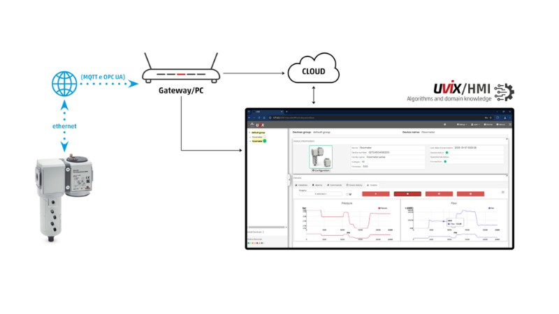

The UVIX Software Platform
The FSX ties into Camozzi’s UVIX software, which handles setup and ongoing monitoring. From a single interface, users can adjust sensor parameters, configure network settings, and define operating ranges without needing separate tools or complex configuration steps.
The UVIX software also provides live data views for flow, pressure, temperature, humidity, power, energy, and dew point. Instead of exporting data into another program, engineers can watch values update in real time and review historical trends directly in the interface. Graphs make it easier to see when consumption drifts, pressure fluctuates, or performance moves outside expected limits.
Camozzi's UVIX software provides a centralized interface for configuring the FSX sensor and for real-time monitoring
Camozzi's UVIX software provides a centralized interface for configuring the FSX sensor and for real-time monitoring. Image used courtesy of Camozzi
